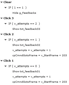

Hi
Normally I use multiple click boxes to perform a click action (no success, no failure), each click box provides a different incorrect "text caption" feedback.
Feedback 1: Retry
Feedback 2. Click X
Feedback 3. Here is a demo of the step (slide continues to next slide which shows a demo of the step).
But I wanted to experiment with an advanced action so that I would just use 1 click box (no success, no failure) with micronavigation (based on Lieve’s article) to display each text caption feedback. (I’m assuming this approach would be easier to implement on all click action slides, especially if I convert the advanced action to a shared action).
I can get this to work for the first two feedbacks but not the last one.
What am I doing wrong?
Regards
Donal.
Here is my setup:

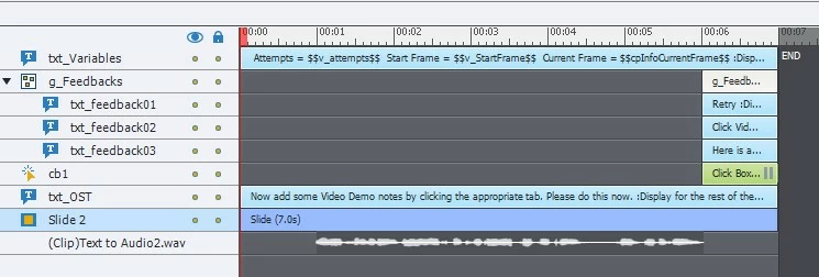

Slide 1: Intro (0.5 sec - 15 frames)
Slide 2: Task 1 – click action
Slide 3: Demo of step
Slide 4: Task 2
Stage (slide 2)
Start frame = 15
Click box displayed after 6 secs (6 x 30 = 180 frames).
When I preview project – this slide (slide 2) pauses on frame 224 (i.e. current frame = 224).
After 1st click and 2nd click I get the slide to return to frame 218    (15 (startframe) + 203).
(returning to this after a holiday and can’t remember why I choose 203)
Timeline (slide 2)
Click Box (cb_1) Properties
“Check” advanced action assigned to click box.

You may need micro navigation (see further) but not for the click box at all. To show the three feedback texts (I labeled them FB_1...FB_3) and grouped them in Gr_FB, this easy conditional action will do the trick:
You don't need to rewind the frames if you provide 3 attempts for the click box. Use this action both for Success and Last Attempt.
However your problem is with the fact that you are leaving this slide with the click box after the second attempt, and have to re-enter it, if I understand it correctly? If you want then the play head to continue immediately to the start of the click box, you'll need to use the On Enter event. This means that you have to track if it is a second visit, and jump ahead if that is the case. That will mean another variable.
Maybe I misunderstood the set up, let me know.

Hi Lieve
Are "3 events" needed because the slide does not automatically continue if there is no success action completed?
Also I still don't understand why feedback 3 does not show.
Maybe it's due to it's position on the timeline - its start and end position is the same as click box.
Here's the attempts-click workflow:
Attempts 0 – 1st click – Execute AA (If Attempts = 0 - Show Feedback 1, Add 1 to Attempts)
Attempts 1 – 2nd click – Execute AA (If Attempts = 1 - Show Feedback 2, Add 1 to Attempts)
Attempts 2 – NOTHING HAPPENS WHEN YOU CLICK
Would expect the following:
Attempts 2 – 3rd click – Execute AA (If Attempts = 2 - Show Feedback 3)
Donal.
