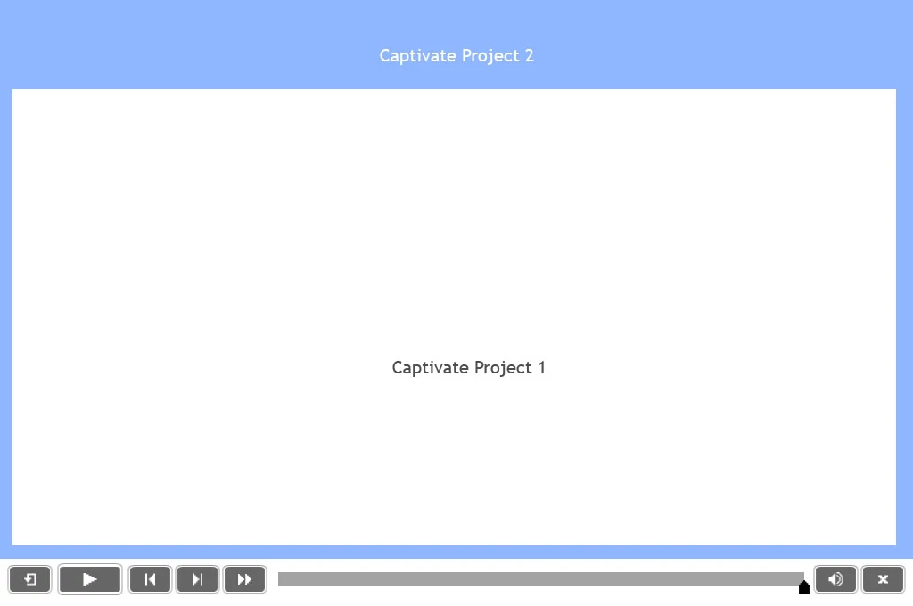

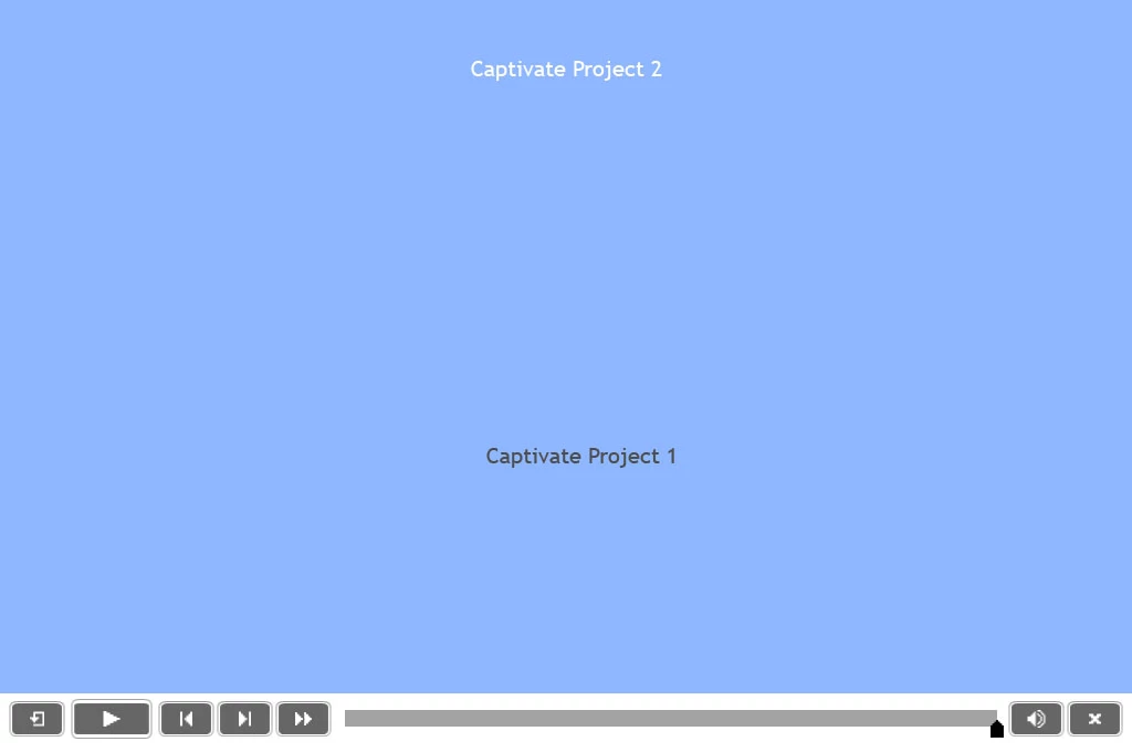

Hi there,
You could try this:
To start with - in your 1st Captivate Project, make sure there aren't any images set to fill the background. By default it looks like Captivate 9 inserts a subtle "BG.jpg" textured background. Delete this (in the properties panel on the master slide view).
Then:
  • In the published files of your 1st Captivate Project (that will be inserted as a web object in your 2nd), navigate to the directory: ../assets/css
  • Locate the CPLibraryAll.css file and open it in a text editor
  • Add the following lines of CSS to the bottom of the file to override the style of the background:
.cpMainContainer,.cpDocument,.cp-movie,.project,.cp-frameset,.projectBorder {
background-color:transparent!important;
#projectBorder{
body {
Some of that code might be redundant. It's a quick and dirty fix so I wasn't being very thorough. I tested this out and it worked. Here are some before and after screenshots:
