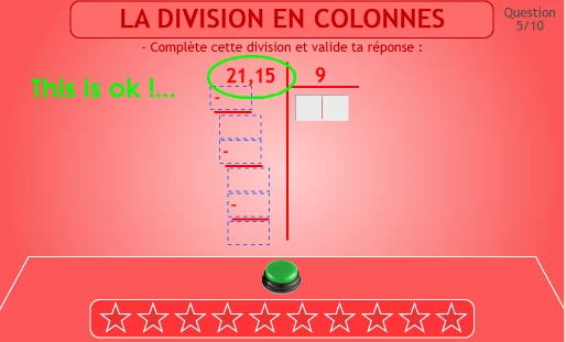

And eveything seems to be ok :

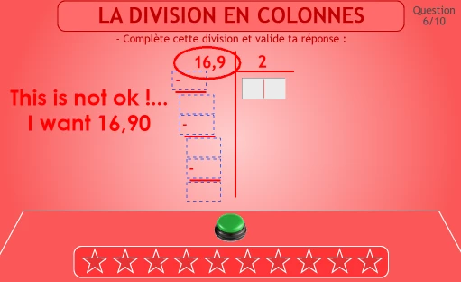

But sometimes this is what happen :
So I need the V_R variable to display 2 decimal digits !...
I have tried :
V_R.toFixed(2)
After the first line of my script 2... But it doesn't seem to resolve this...
So your help is required !...
    Dirlo
    DirloAuthor
    November 10, 2020
    I answer myself as I believe I found a solution...
    In fact it appears that the method "toFix" is not compatible with the function "toLocaleString" !!!...
    So I had to put this :
    var V_R = VD_R.toLocaleString("fr-FR", {minimumFractionDigits: 2});
    And it seems to be ok !...
