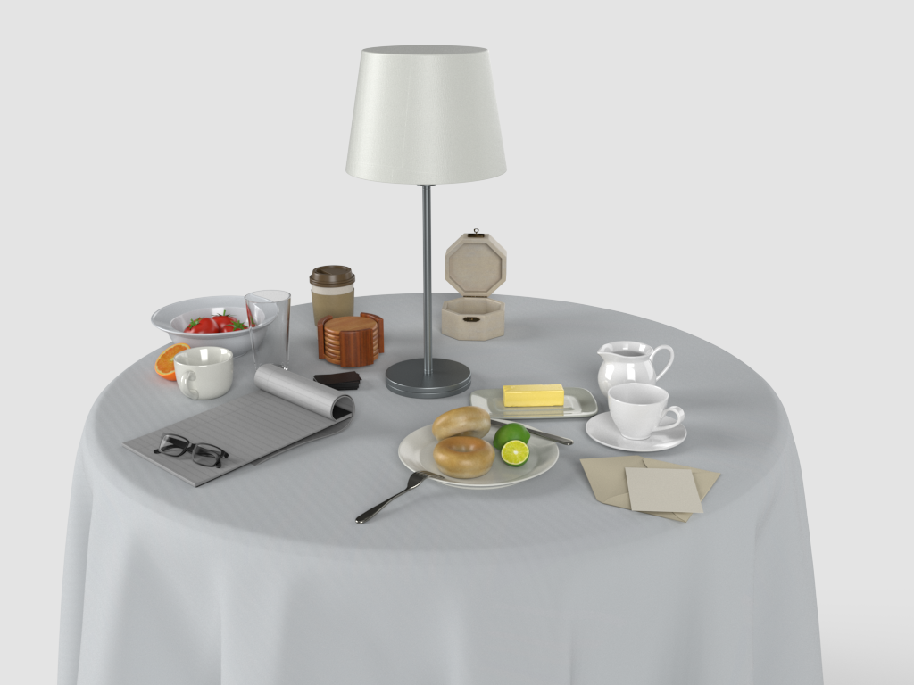

Hmmm... yeah, that is puzzling for sure. I've been rendering at 32bits and it made a difference in quality for me but strangely didn't increase the file size so the quality possibly maxes out after a certain resolution. I definitely notice more aliasing and artifacts when I go over 3000 pix.
I experimented with quality on another level by placing multiple models into one scene and seeing at what point the render quality starts to decrease. I was pretty impressed by how many models I could add but at some point it started dropping out information during the render and left black spots (usually when there is a glass texture involved). I'll attach examples. My point being that there definitely seems to be a cap on the processing output that is lower compared to other 3D software packages.
I've had some 3D modeling and animation training in Maya a few years ago but things are changing so fast and the software gets more complicated each year (or I am getting stupider lol) so I hear you on this being a very user-friendly application. I really hope Adobe sorts out the rendering quality because it will make Dimensions an incredibly useful tool.
