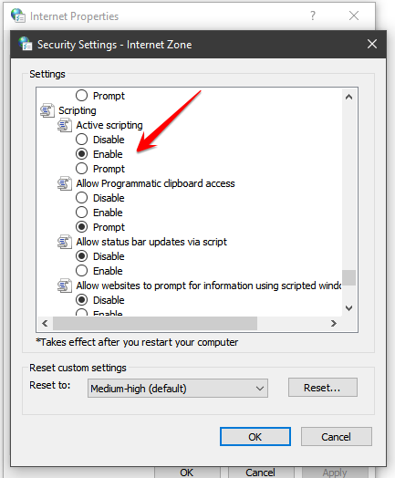

July 2020 and I too had this problem, and for me I have a brand new computer and have never installed anything Adobe except flash player; that's when I realized. All Adobe GUI's (graphical user interface) are governed  by Windows Internet Explorer privacy setting regardless if you are using other internet browsers. So you have to check your Windows Internet Explorer settings (not Edge) and insure that Java Script and Scripting are enabled. You can do this one of two ways. Either open Internet Ex
Community Expert , May 27, 2022 May 27, 2022
to clarify @iDaze's solution:
Adobe's GUIs (graphical user interface) are governed by Windows Internet Explorer privacy setting regardless if you are using other internet browsers. so you have to check your Windows Internet Explorer settings (not Edge) and insure that Java Script and Scripting are enabled.
one way to do this is to open Control Panel (icons) > internet options > "security" tab > custom level > enable "scripting" and "scripting of java applets" (both are towards the bottom) >

I found a solution that worked for me. Following the steps for Internet Explorer below fixed the issue:
https://helpx.adobe.com/x-productkb/multi/enable-javascript.html

July 2020 and I too had this problem, and for me I have a brand new computer and have never installed anything Adobe except flash player; that's when I realized. All Adobe GUI's (graphical user interface) are governed  by Windows Internet Explorer privacy setting regardless if you are using other internet browsers. So you have to check your Windows Internet Explorer settings (not Edge) and insure that Java Script and Scripting are enabled. You can do this one of two ways. Either open Internet Explorer and click on the "gear" "settings" > internet options or via Control Panel > internet options. Once you have "internet options" gui open you click on the "security" tab which is where you will find your internet security settings, and will have to check to make sure your security settings via "security level" in the "security tab", and make sure "scripting" and "scripting of java applets" are "Enabled". (once the changes are made remember to click "apply") This will enable and allow java script for Internet Explorer. Again you are doing this regardless of what internet browser you primarily use because Adobe gui's are governed by internet explorer settings. I remembered that I always have this problem when I have to update "Flash Player", and I have to go through this same hassle of enabling Java on Internet Explorer every time I have to update Flash Player.
one way to do this is to open Control Panel (icons) > internet options > "security" tab > custom level > enable "scripting" and "scripting of java applets" (both are towards the bottom) > click apply

I had the same issue and I fixed it with internet options and setting the security level from high to medium-high

It is very strange - but you need to open Internet Explorer and enable Javascript in there (https://helpx.adobe.com/x-productkb/multi/enable-javascript.html)
Even if you are using Chrome or Firefox to authenticate.
It works after that!

My case is because the internet explorer's javascript is disabled, and this might usually caused by Windows servers' internet explorer security enhanced configuration, I disabled it, allows JavaScript and it finally works. Also, the Alternative downloads will also work if you don't want to configure your IE settings since it requires you to put your account&password by default.
