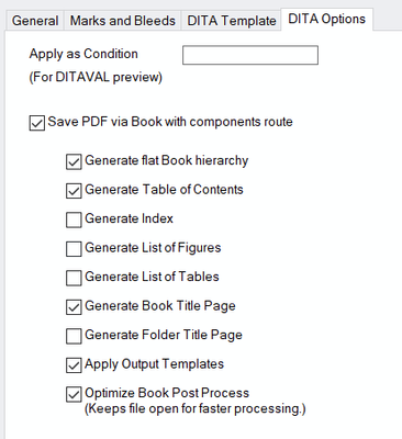

I have inherited a documentation project that uses FM2020, structured authoring with DITA 1.3.
We have a customized 'ditafm-output.ini" file as well as customized .STS settings file. I am trying to understand which changes that were made in these two files actually matter, which means understanding how these different settings are used/applied. When I look at the settings in these two files, there appears to be a certain amount of overlap. For example, in the .STS file, the DITA Options tab lists about 10 items, all of which I "think" appear also in the .INI file.
Which file's settings are used under which conditions?
NOTE: the instructions we follow to generate a PDF are to use File > Publish and then select the correct Settings File, select PDF and then click the Generate Selected Output button.
I have tried searching/reading the various Framemaker help files, but have not found an explanation yet.

I emailed Adobe directly to get some clarification, the following were their responses:
  • "The settings mentioned under DITA option in Sts files are honored while generating pdf. The same settings are honored from ditafm-output.ini only when saving ditamap as book with components."
I then pointed out that in their user documentation "Adobe FrameMaker INI Reference (2020)" appears to contradict that statement, because there is the following:
  • "There is an option in ditafm-output.ini "SavePDFViaRoute" which states the following:
    • When set to 0, generates a compound .fm document and then a PDF
    • When set to 1, generates a book and then a PDF. Use this option when you need book components,
      such as index, ToC, and title page, in your output."
So I queried them explicitly about this option and their response was:
  • "SavePDFViaBookRoute This flag has no importance and the settings is governed using STS only"
Jeff_Coatsworth
August 31, 2023
I would suspect that that line only applies to PDFs created using the older Distiller route (both Save As and Publish use the new PDF creator).
