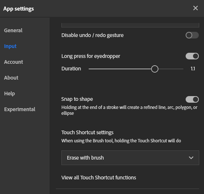

second one, the new "snap to shape"
create your shape in one single stroke and hold at the end of the shape. The stroke will then snap into a perfect circle/square/triangle, whatever.
You can set up the parameters by going to the cog wheel on top right of the interface, choose "app settings"> "input" and then scroll a bit to change the settings
