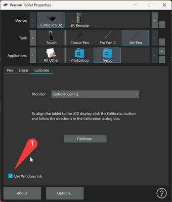

So I have a wacom cintiq and it has the same issue. If I use the mouse the lag is gone with the pen its there. If i turn of 'Use Windows Ink' in the Wacom control panel the lag is gone. However there is no pressure sensitivity, it acts like a mouse and hence unusable again. Such a shame
