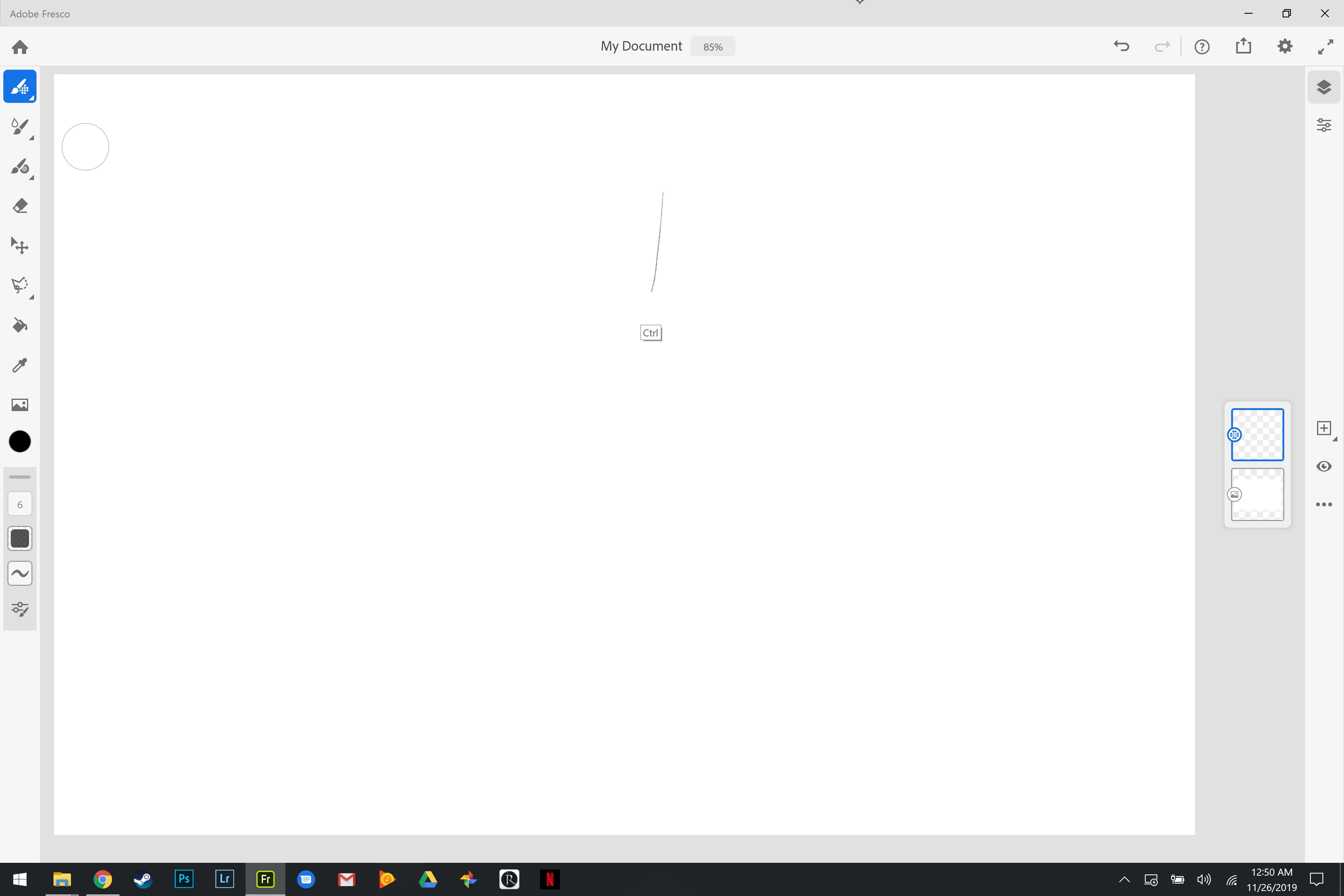

I normally use Sketchbook pro or Photoshop for illustrating and having just heard about Fresco, l thought I would give it a try instead. I'm noticing a high level of inaccuracy in the pen input and have double checked the other two programs and restarted my device to make sure it isn't the pen or screen. Where windows shows the pen to be touching and where the program is drawing are about a quarter inch apart from one another. I'm currently using a Surface Book 2 with the newest non-slim surface pen & am excited to get this working but just want to see if anyone else has noticed an issue as well. Uploaded is a screenshot with me attempting to show the difference; the 'ctrl' text is where my pen cursor is.

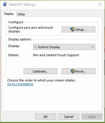

Wow, that's definitely not normal. I use a Surface Pro (5th gen.) and have not had this problem. You might need to calibrate your tablet pen. Click your Start button and search for "calibrate pen".
Next, tap Setup, and follow the on-screen instructions. After you've completed the Setup, I would choose to Calibrate and follow the on-screen instructions to complete the calibration. (It will ask you to click on crosshairs on your screen several times.)

The above user seemed to be able to find out it has to do with smoothing. I would love not to have the requirement of turning that down/off just to get the pen to work accurately. Would you like me to still email? I am not sure how to share my brush settings, but have tried using it with sketching, marker, and painting options with just default settings. Smoothing helped them all but would appreciate knowing if it is a bug or something that is intended.
