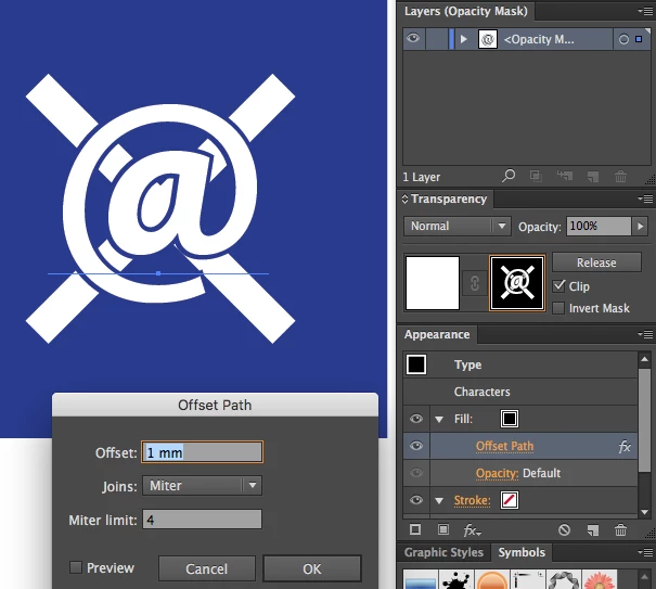

Hi all,
I'm using AI 2015 CC. I have a design with white text over some white lines in a kind of an "X" for a t-shirt design. I'd like the text to have a transparent outline around the letters, so they do not blend in with the lines that are supposed to appear as being behind the text.
How can I do that?
Thank you
    Correct answer rcraighead
    One way would be to set your artwork (white lines and text) as a "Opacity Mask" on a white rectangle. This would allow the text to remain fully editable on the mask. Add a Black Fill Attribute on top of the Character Attributes in the Attributes Panel and assign an "Effect>Path>Offset Path" to it to create the "transparency" to the rectangle.

    rcraighead, thank you, that is exactly what I am looking for. The top image looks very close to my drawing.
    I've been working with someone, and they actually produced the effect, but, they changed some of letter's font sizes. I asked them to correct it and create it without changing the font sizes, but they have not replied to my request, so, I am trying my hand at it.
    In one of the files she sent me, I found a white rectangle to the right of the drawing and dragged it onto that.
    I've selected all and found the "Opacity Mask".
    As for "Add a Black Fill Attribute on top of the Character Attributes in the Attributes Panel", I've found the Attributes Panel, so I think. I've clicked the upper right icon, and see: "Show Overlay Print Only" and "Hide Note".
    Am I close?

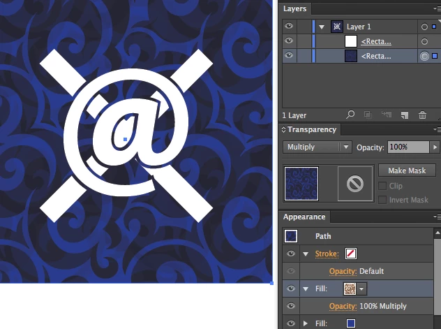

    I am close, got to here:
    Since I plan to print on a t-shirt, I don't have a background.
    Trying to make it to look like:
    I've grouped it all, yet, without a background, when I implement the mask, my entire drawing disappears:
    What do I need to do to make and see that kind of effect, yet have no background?
