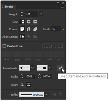

While I do understand your frustration with it, the functioning is not random or (un)lucky in any way. The left arrowhead menu applies an arrowhead to the path's origin, and the right menu applies one to its termination. You may not know which end is which until you apply an arrowhead, but if it comes out wrong, you only need one more click (on the Swap button) to correct it.

That is normal behaviour. It depends on the path direction where the arrow is placed.
You can change the path direction in the Object menu > Path submenu.
Or you can use the little button to the right of the arrow dropdown field in the Stroke palette to invert the arrow.

The first question in such a case is what is your path direction. The arrows suit the path direction, not exactly left-to-right. So, if you draw your line right-to-left, the arrow will direct to the left.
You can change the path direction using Object > Path > Reverse Path Direction.
