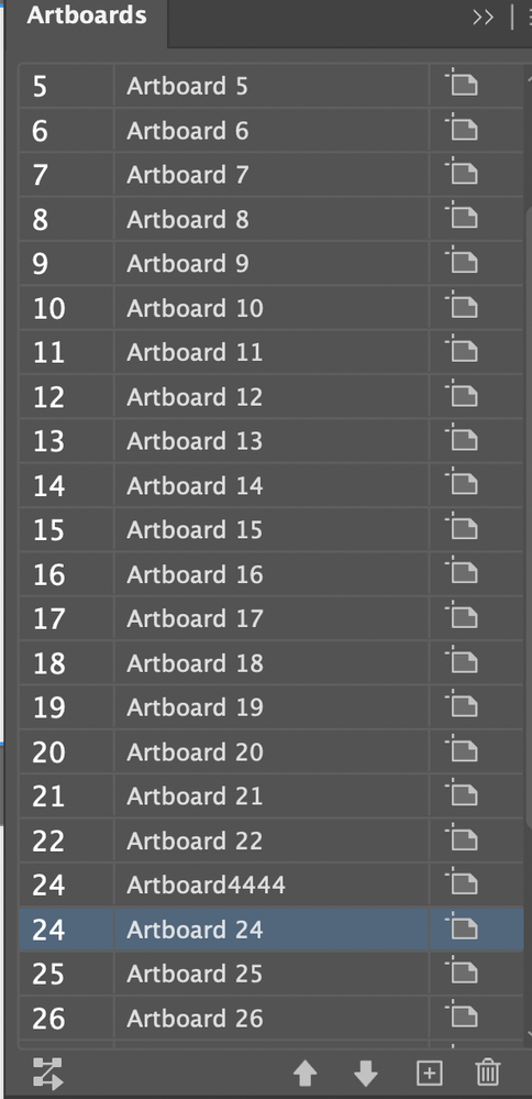

The same thing just happened to me. I've yet not found the way to fix it... missing number 23.Screen Shot 2021-10-04 at 23.07.49.png

I am experiencing the same issue regularly on Mac, Illustrator 26.03.01, both when creating new documents from scratch with mulitple artboards, and when duplicating artboards.

This error is still occuring. When I duplicate an artboard, or create a document with multiple artboards, I am getting duplicate artboard numbers, which is causing an error when i try save them as individual pages.
In this case you can see that there is a duplicate artboard 3 and no artboard 2.
Screen Shot 2022-02-23 at 10.17.03 am.pngScreen Shot 2022-02-23 at 10.18.20 am.pngScreen Shot 2022-02-23 at 10.26.08 am.png
Are we any closer to finding a fix to this bug?
