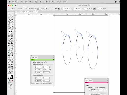

The handles of one point? If they already exist, you can select the point and then scale.
For handles of multiple points, try the plugin VectorScribe with its PathScribe tool. (not for free)
Thanks for all of the responses. I followed the link showing how to grab two or more handles on different shapes and moving them all at the same time, but they all pull in the same direction.
Jason Hoppe wrote this:
"If you are trying to pull handles equally after they are created, only one handle can be pull at a time."
I think that is the correct answer within native Illustrator.
In the examples above, I made an oval, then with the selection tool, I held the option key down while dragging the side handles to make the oval more skinny. Great.  In the third example, I have a shape in which the left handle at the top is not the same length as the handle on the right, and I'd like to find a command that will equalize the lengths and let me drag them in or out. ...symmetrical handles. I would have hoped holding the option key down while dragging would do this, and it seems like it would be a good feature for Illustrator.
I have a signmaking program that has this feature and I use it all of the time.
Astute Graphic's Vector Scribe might be the solution. I need to review its features. At least asking the question here gives me some direction to pursue.

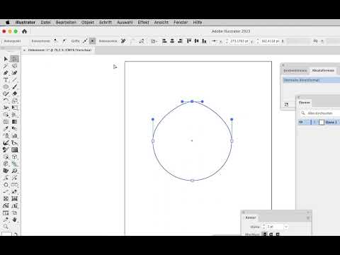

Is this what you want? https://youtu.be/v5JHbkZMSds
Votes

Hi Monika, The video shows how to make the handles, or multiple handles non-smmetrical.
