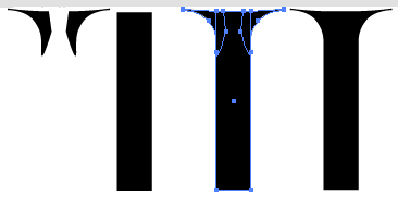

Could it be that you need to use Pathfinder?
Here are a couple of serifs and a stroke that I need to put the serifs onto.
Position the serifs on the stroke, select serifs and stroke and Pathfinder ((panel) Unite.
