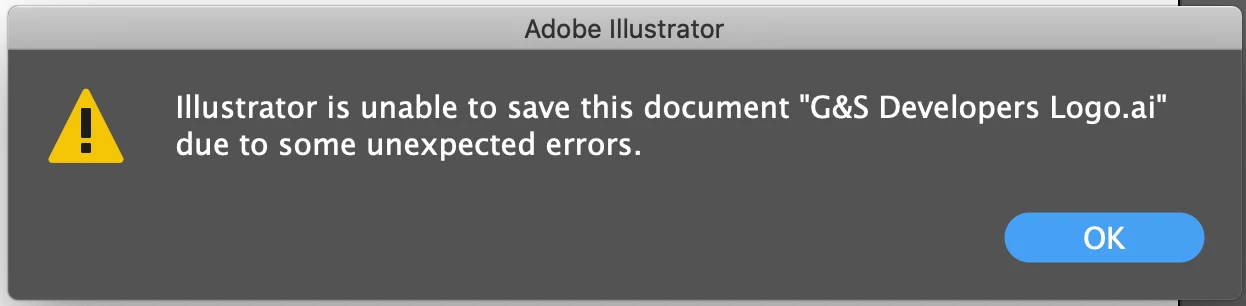

Can't save due to an unexpected error (latest version 24.0.1 and macOS Catalina) on a Server
  • December 19, 2019
  • 1680 views
Now I get this. Adobe, I'm getting tired of paying a monthly subscription for betaware.
Solutions?
EDIT: Seems to happen while working from a doc parked on a server. Seems to save ok when working from my local hard drive. After getting the alert, I close the doc, assuming it will revert to the unmodified version, but it deletes the file off the server. Wipes it off.
(Mac OS Catalina, Illustrator 24.0.1)
{Renamed By MOD}

Johnny Sokko
December 19, 2019
Rishabh,
I just went back to Illustrator 2019, and it is saving to the server just fine. I can only logically conclude that the 2020 version of Illustrator is the issue. I'm also not the only individual experiencing this problem, as other community members are reporting in your bug report area.
