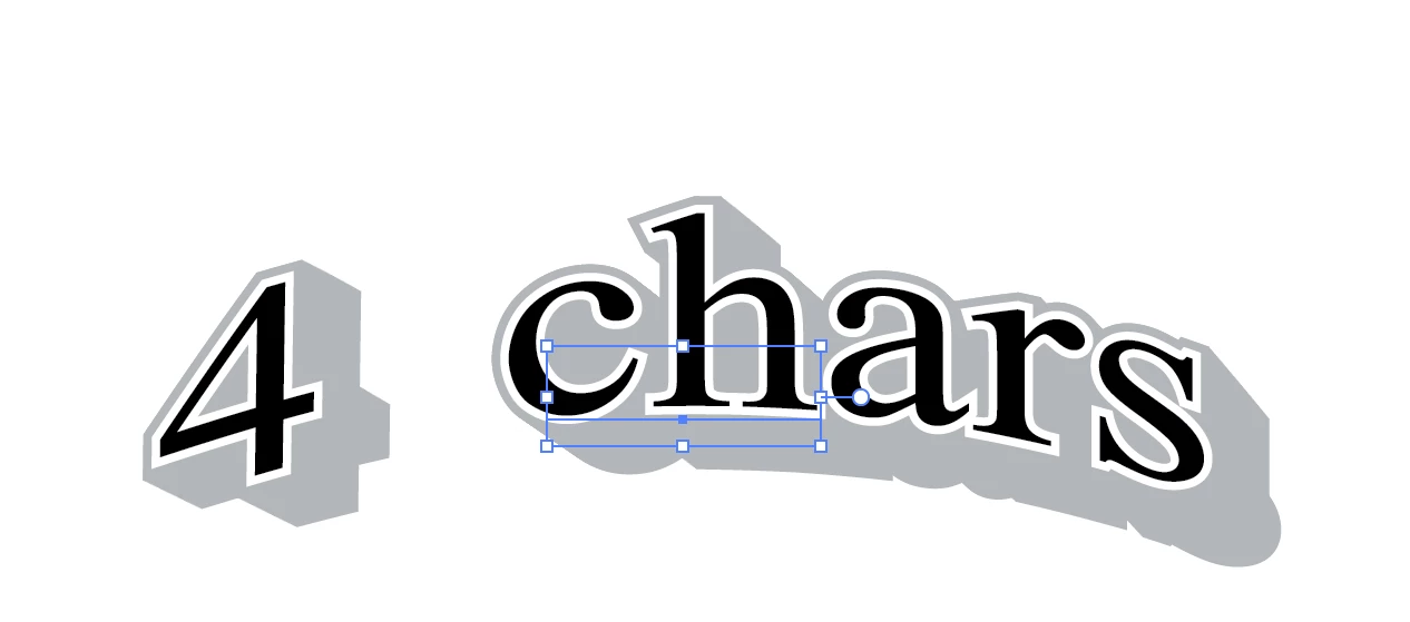

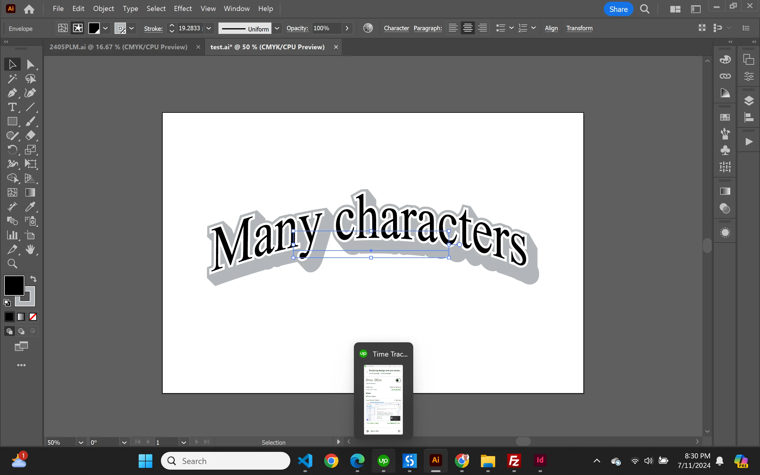

I know typically to do find/replace operations on text in AI scripting, we iterate through a doc's textframes and find/replace contents. However, I am dealing with a document whose text frames are not actually TextFrames, but PluginItems. I'm not sure how these frames were generated (doc came from client's client). Essentially, I'd be OK if I could somehow record an action of F/R and export it out, and replace the Replace contents with dynamic content. Is that feasible?  As far as I can tell, the PluginItem has no contents property that I can change.

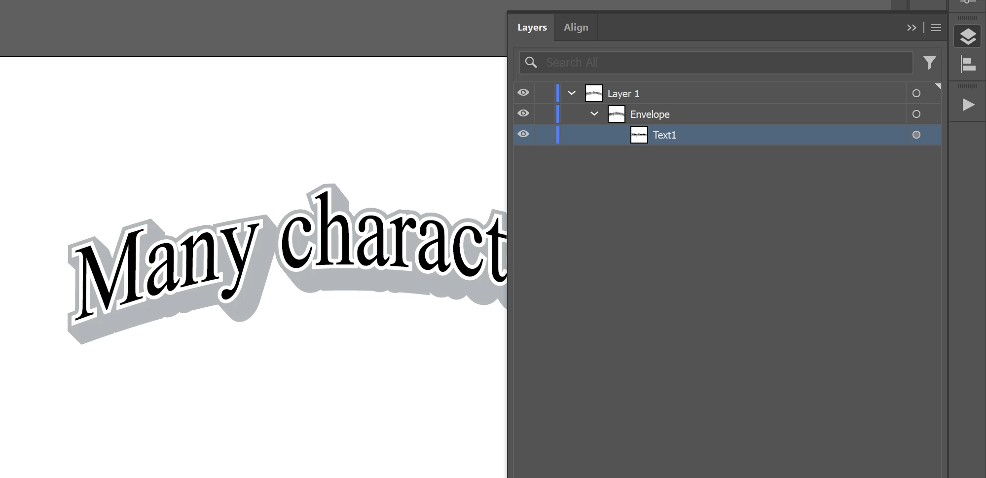

Alternatively, does anyone know how I can achieve the same outcome in the attached doc, which uses the plugin frame. Essentially, it functions like a curved area text, but stays at its defined bounds regardless of how many characters are input. TIA. Edit: Forum is not letting me post AI file, but I can send DB link privately. Attaching screenshots. Frame object is very small, but curved text goes well outside those bounds, but stays within those outerbounds regardless of how many characters are input. Looks like maybe it was created by a plugin called Envelope, as the item sits inside another item called Envelope.

Hi @brian_p_dts, those look like "envelopes" (which are "PluginItems" to the scripting API). If they are, you can use find/change if the envelope items are in "Edit Contents" mode. Choose menu Objects > Envelope Distort > Edit Contents or
app.executeMenuCommand('Edit Envelope Contents');
They aren't the easiest things to work with via scripting and attempting some things cause crashes.
- Mark

Hi Brian, I'm not sure, but I recall there was something hairy about working with envelope contents. This is my memory (can't find code right now): the idea is you access doc.stories, then find the parent text frame of each story and access it that way. It only works if the Envelope is in Edit Contents mode I think. Also if there are no "non-envelope" text frames in the document it will also fail, so you need to create a temporary one and remove it afterwards.
Also, maybe have a look at this solution. (I haven't tried it, but it might be the simplest.)
- Mark
