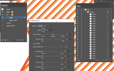

This screenshot shows the added Scribble Effect.
Adjust the scribble effect to get your desired result which is a single stroke placed along your stripes.
If you are happy with the effect, save it as a Graphic Style by using the Graphic Styles panel. This works almost like an Illustrator swatch, but in addition to changing a color or pattern or gradient of art it also can hold an arbitrary amount of appearance effects. Most importantly, this style can be used inside of an Action to instantly and automatically add these effects.
Finally, use the Object > Expand Appearance to turn these effect-based strokes into vector paths.

Update: you can even forget the pattern! You can actually use your current technique by using a blend, then using a clipping path and ensuring the blend is expanded. All you need to do is first Divide with Pathfinder and then add a scribble effect to the result. Then Expand Appearance and you get a group which has your original divided lines at the bottom and just the lines you want at the top!
Of course, using a blend is going to be more than a one-click operation of just using a swatch or a graphic style containing a swatch but you could technically do a whole new blend each time and have all kinds of funky wavy lines in there. You ever wish to plot the kinds of intrucate geometric designs they have on money, but were constantly frustrated by not being able to clip it? Have we got a solution for you! (OOPS: this relies on the Scribble Effect adding only the kinds of lines it knows, so at most you could only to crazy zig-zags but not custom-warped or globally-curvy lines)
The whole thing can be automated as well by actions, and you can have different actions which could paste in different huge squares of pre-made blends in behind your shape, from other files
Note that after you expand and then divide, the result may be all clear paths - in which case just give it a stroke of your favorite color again. And you don't have to trim & merge or anything.
Dial the scribble effect in so the line appears and there you go!
Then expand the appearance:
You get the two groups:
And this is the result that has the lines closer to what your examples are:
So now you can have a couple of options, both relying on the Scribble Effect whose unique properties we are exploiting to reduce a hatch-filled shape to just the filler lines as strokes only.
