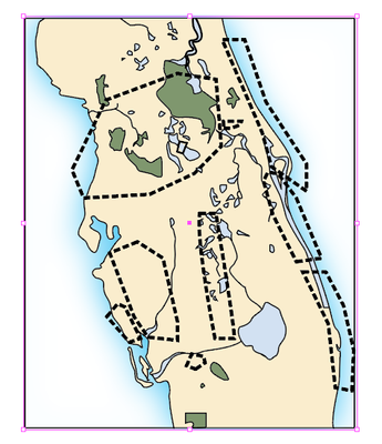

I am working with a map.
I want to have an outer glow along the coastline and a drop shadow under the frame.
So I applied the outer glow to the Live Paint map then made a clipping mask the same size as the map frame to limit the glow just to the coastline. Like this:

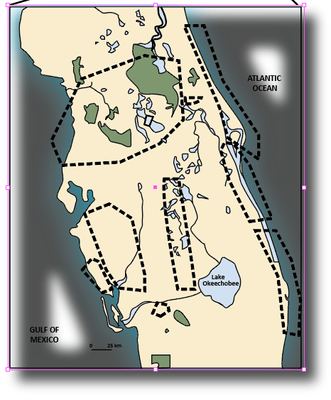

But I still want a drop shadow on the map. The “white” area in the Live Paint is void. So when I apply the drop shadow to this I get this:
Looks like the drop shadow is applied to objects inside the Clipping mask of the Live Paint.
I just want the drop shadow around the frame in the above image.

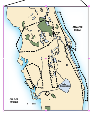

Aug 05, 2022 Aug 05, 2022
I just selected the thing and applied a drop shadow. I don't know if that is how you want it to look like. Your demo file also doesn't have the outer glow, so I'm at a loss.

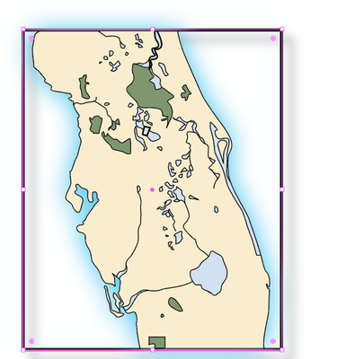

This is the image I want to apply the drop shadow:
You can see that the drop shadow is inside the image

I noticed that the .ai file in the DropBox does not have the outer glow effect. My mistake.
OK - I updated the DropBox link with the .ai file that has the outer glow applied plus the clipping mask.
It looks like this:
Aug 06, 2022 Aug 06, 2022
In the outer glow effect change the blend mode from Screen to Normal.
And then select the clipping mask object with the direct selection tool and apply a white fill to it.
And then you can apply a drop shadow to the complete object. You need to select it with the selection tool for that.
