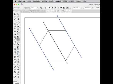

Copy link to clipboard
Copied
For example like this: https://youtu.be/f0L6pmmDwLg
The process can be organized better, of course.
Uploaded by Vektorgarten - Illustrator Tutorials on 2024-07-11.
Votes
