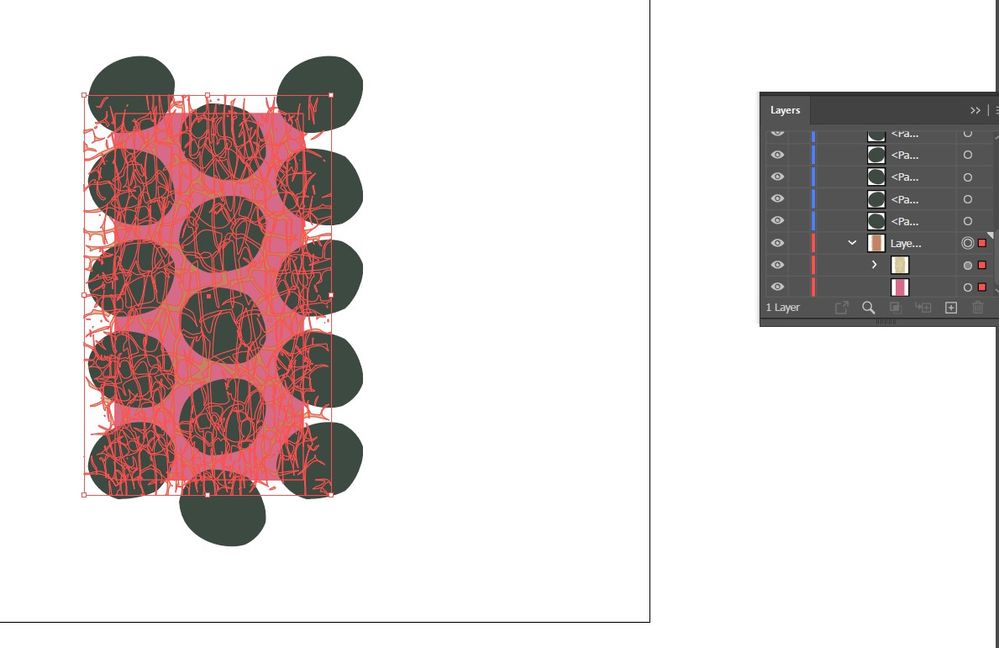

still doesn't work for me, trying to make my repeating pattern with texture on a background doesn't work. made new layer with background colour and texture then hit ctrl 9 - will NOT make artboard. any other ideas please? this is so frustratingScreenshot 2023-02-15 085247.jpg

Explorer ,
Jun 10, 2023 Jun 10, 2023
Hey GuylaineC, can you please explain the issue in detail, i'm not sure, maybe I'll be able to figure out a solution, thanks 🙂

By @GuylaineC
Exactly what do you have selected. You need to select only the rectangle. Nothing else. And also this rectangle must not be rotated or a clipping mask.
