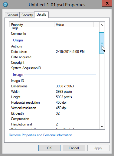

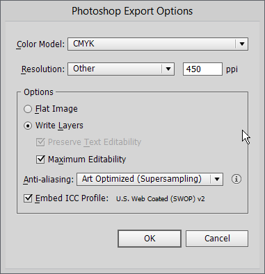

One portrait letter-sized with a circle and a 1 pt black outline using CS6. Exported with Art Optimized, 450 dpi to a PSD.
PC version. JPG exports same size/resolution, as does PNG.

Yup. There it is. PSD works great for me, too.
JPG, still not.

I am uploading a sample file to SharewithAi@adobe.com right now. I cannot get this file to export to Photoshop CC without getting an error. I've tried everything I can think to do.
