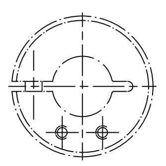

I am using Illustrator CC 2015.1.0. I have dashed lines in my drawing for center line.
I have a script to align dashes to corners and path ends. This works fine. Then I have my drawing in Illustrator:

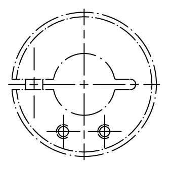

The export to png and jpg is correct. But the export to svg is wrong.
The dashed line in the center is not correct. Look here:
It seems, that the SVG Export adjust the dashes. What can I do?

    SVG doesn't support this alignment of dashes.
    March 7, 2018
    Thank you for this quick response.
    That means, the SVG Export is not using the alignment of the Illustrator?
    Monika Gause
    Brainiac
    March 7, 2018
    The SVG standard does not support the alignment of dashes.
