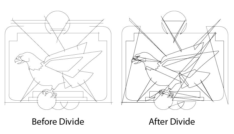

I'm having a similar problem with extra lines when using Divide.  It seems to be file-specific, and although I've run into this before, it seems random and doesn't always create extra lines.  For example, I can create a new design in a new document and then Divide with no problem, no extra lines.  However, when I copy and paste the design from the document that creates the extra lines, the same thing happens in the new document:  extra lines.  I'm an experienced user and made sure there was no fill when drawing the design, so it's a mystery at this point.  I'm hoping to salvage the design if possible without re-drawing, so any help appreciated.  I can provide a file link if requested.Divide weirdness.jpg

I assume it's the fill rule that is applied to the paths.
If you select all the paths and set the fill rule to Non-Zero instead of Even-Odd, then "Divide" does not close the paths.
Explorer ,
May 12, 2020 May 12, 2020
Delightfully enough, your suggestion worked just fine.  Strangely, I did not consciously make any changes to this fill rule and I'm curious to know how it happened on those troublesome files when most of the time it worked fine.  Is there some specific combination key command that I could have accidentally hit to change the Attributes?  Thank you for your diligence in finding a cure.
