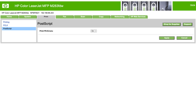

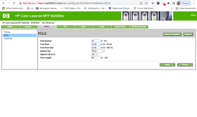

New Here ,
Mar 17, 2023 Mar 17, 2023
seems like i have it already?
Indeed, Honey.
What happens if you switch to Postscript and try again?
New Here ,
well, under "PostScript" - "Print PS Errors" is toggled on - would i need to do anything else? this was on and still getting the blurry prints
