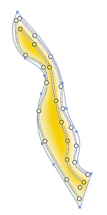

You can use multiple blends to create transitions with different intensity concentrations along the centre.
The images below were:
1) Made from 2 bounding paths, then
2) A soft transition based on a centre path made with a 1 step blend followed by a 256 step blend of those paths all being 255 Red and the outer paths having an Opacity of 0%, then
3) More intense transitions based on a centre path made with a 1 step blend followed by a 3 step blend, only keeping the steps closest to the centre, followed by a 256 step blend of those paths all being 255 Red and the outer paths having an Opacity of 0% and the paths closest to the centre having an Opacity of 50% (more intense) and 30% respectively (most intense).

jd,
Click/RightClick to get closer

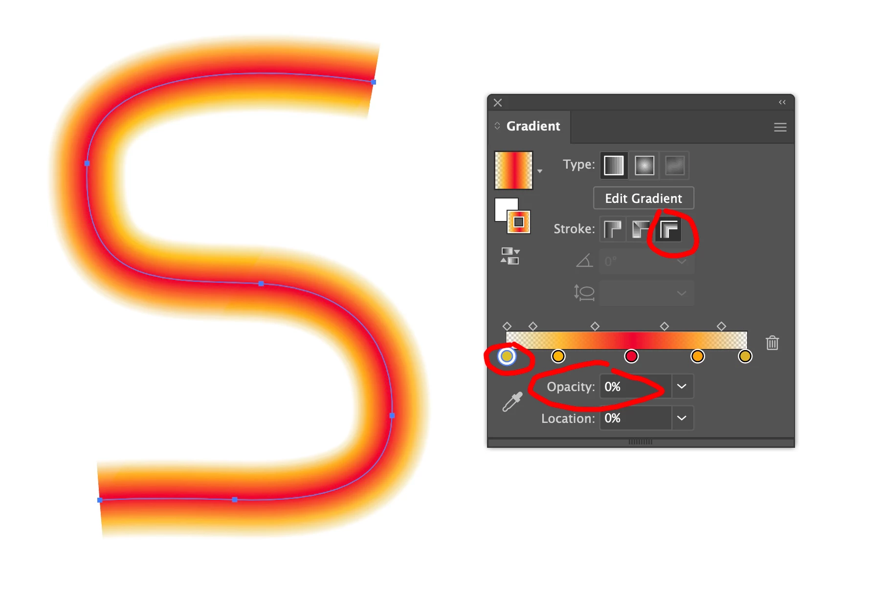

We can provide better suggestions if you provide a screenshot of what you are looking to achieve. My best guess is these are the important settings you need to look at in doing a gradient along a stroke.

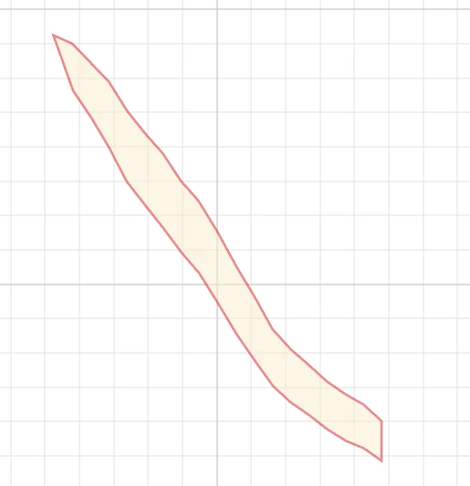

jdballouAuthor
August 14, 2023
Here is the shape I have.

Probably using a blend:
But possibly also with freeform gradients

Gradient across the stroke is not an option?
