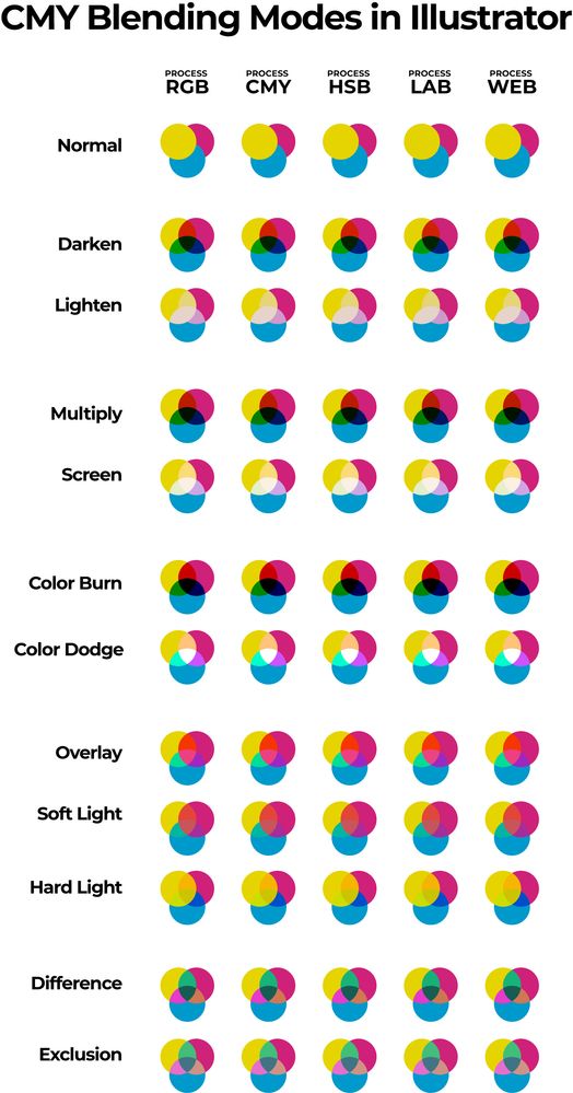

I spent a good hour or two writing out a detailed post about some confusion I have witessed regarding blending modes in Illustrator. I included a diagram that demonstrated the blend modes  did not care which definition you used to create your color, the results would be the same..
When I tried to submit the post, I got an authentication error and I just don't have it in me to write it all out again. Here is a JPG of my diagram demonstrating the same results for different blend modes in eery color space in Illustrator.
I am hping that I did something wrong and that someone can figure it out. DM me for the original Illustrator file where you can select any circle on the page and view its color definition and blend mode.

Jason,
Can you state which blending modes are involved and roughly how in the confusion you have witnessed?
