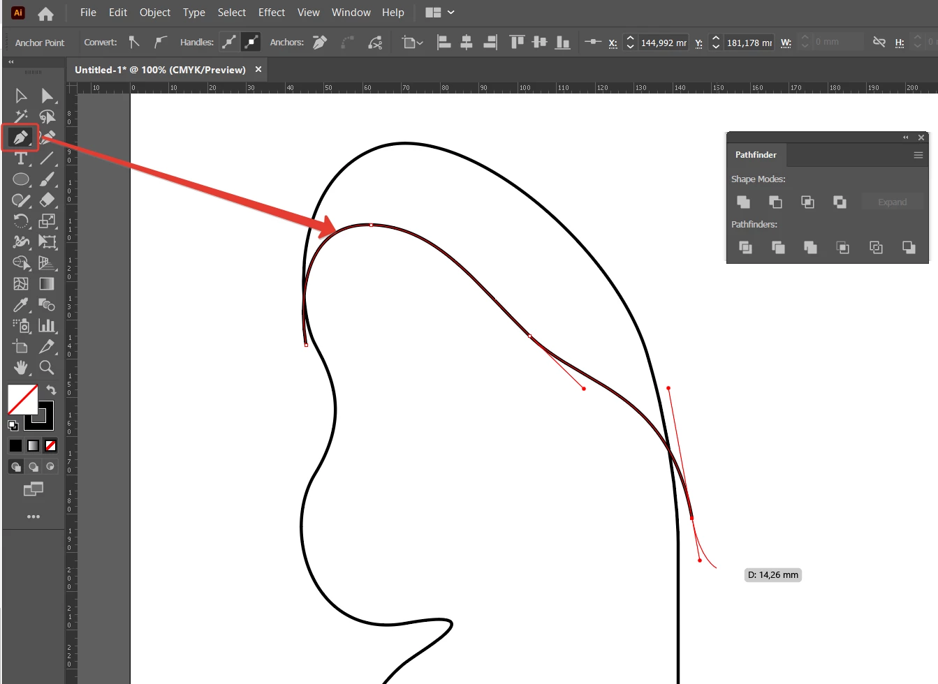

Hi there!
I would like to have some information about how to make an object that would follow the exact path or shape of another object in Illustrator.
Here I have an example of an object (not the exact one that I want to create and use, but similar to the one in blue) that I want to create that would conform to the top part of the butterfly wing that I could later combine with the wing (but keep them both as two separate shapes).
Please let me know how best to accomplish this ...
Thank you!
Correct answer Anna Lander
Another way to make areas:
1. Create the main (outer) shape.
2. Using Pen tool, draw the needed line through the shape. Press Esc to stop drawing. Make sure that the line has only Stroke, no Fill.
3. Select both shape and line and click Divide button on Pathfinder panel. It creates a group of 2 closed shapes.
4. Ungroup and set the attributes like you want.

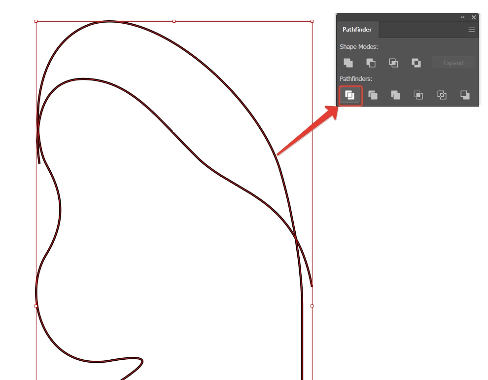

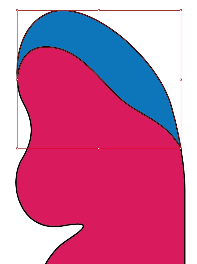

tromboniator
January 9, 2021
This is one way. As with most things in Illustrator, there are multiple possibilities.
(1) Draw the path for the shape you want for the top of the wing, and close the path so that it overlaps the pink portion.
(2) If you did (1) as a stroke, swap stroke and fill.
(3) Copy the pink wing shape, paste in front. Object menu > Arrange > Bring to Front. ( I've changed the color only to indicate that it's no longer the same path as the original pink.) Select the path from (2) and the front wing shape from (3), and in the Pathfinder panel (Window menu > Pathfinder) click Minus Front, as indicated.
(4) The shape from (3) is gone, and the path from (2) now perfectly matches the top of the pink shape.
(5) Shows the paths with matching edges separated.
I can't promise that it's the best way, but it is a way.
