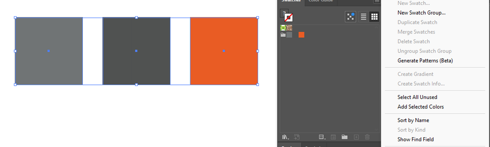

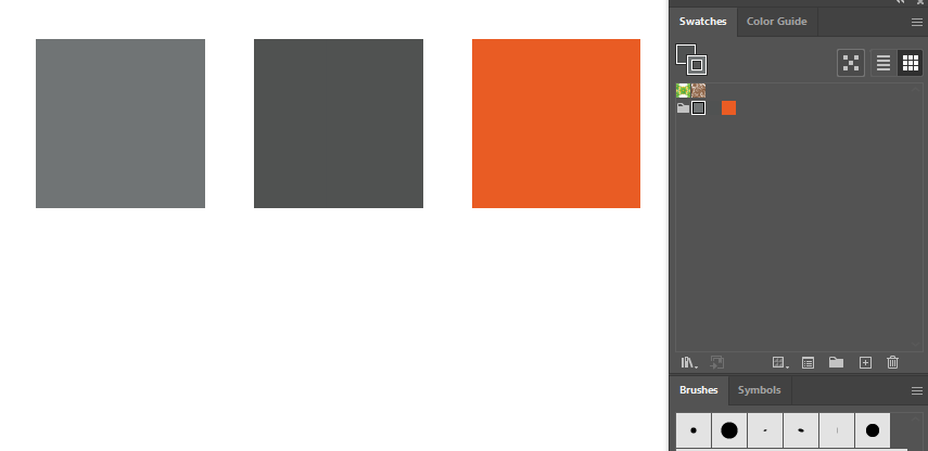

Jan 06, 2025 Jan 06, 2025
I've selected all three swatches but the option to select the 'create swatch info' isn't available, see attached picsScreenshot 2025-01-06 100734.pngScreenshot 2025-01-06 100804.png

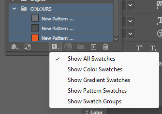

Are these normal color swatches? I miss the registration swatch in your screendump.
Maybe you are showing only pattern swatches. Can you show all swatches?

Just selected that but the option to choose 'create swatch info' is still unavailable, see attached picsScreenshot 2025-01-06 105314.pngScreenshot 2025-01-06 105347.png
It does not work with patterns, only with color swatches.

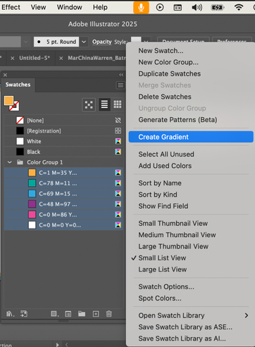

New Here ,
Feb 10, 2025 Feb 10, 2025
Create gradient info doesn't show up at all for me. I have the colors in a New Group.  I have selected all of the colors in the swatches panel, but that option does not show up under Create Gradient
New Here ,
I meant to say, "Create Swatch Info" doesn't show up for me under Create Gradient
Feb 11, 2025 Feb 11, 2025
Which Illustrator version are you using?
