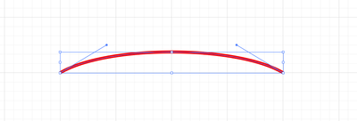

Based on my (mis)understanding that you wish to have a tight control of both shape and symmetry, working with Handles, without cutting the rectangle, here is a way with the help of the Line Segment Tool and with Smart Guides telling you when you are within snapping distance, steps shown below:
1) Create the rectangle;
2) With the Line Segment Tool ClickDrag upwards and inwards in the desired initial direction of the top curve from the top left corner Anchor Point, then change the colour of this guiding line to red;
3) Reflect the guiding line from 2) horizontally (or vertically), then ClickDrag it by its top left corner to snap to the top right corner Anchor Point, then change the colour of this guiding line to blue, then select the rectangle and bring it on top of the guide lines (you can Ctrl/Cmd + X + F);
4) With the Convert Anchor Point Tool ClickDrag from the top left corner Anchor Point to the end Anchor Point of the red guide line;
4) With the Convert Anchor Point Tool ClickDrag from the top left corner Anchor Point to the end Anchor Point of the blue guide line;
Now you have symmetrical Handles on the top corner Anchor Points and a symmetric flat top curve;
5) ClickDrag the left guide line by its top Anchor Point to snap to the top left corner Anchor Point, then change the colour of this guiding line to blue, then Direct Select the flat top curve, then ShiftClick each of the Handles or ShiftClickDrag over both, then use the up/down arrow keys to establish the desired top curve, still symmetrical;
This is the key change of shape;
6) With the Line Segment Tool create a red horizontal guide line for the bottom curves (shown half way up the rectangle), then bring it beneath everything else (you can Ctrl/Cmd + X + B);
7) DirectSelect the left lower curve, then ClickDrag the Handle along the blue guide line to the intersection with the red horizontal guide line to change the curve, then repeat for the right side;
To adjust the lower curves until satisfied:
8) Move the red horizontal guide line to a new height (shown two thirds of the way up the rectangle);
9) Repeat 7) for the new position of the horizontal guide line.
8) and 9) can be repeated until the right lower curves have been established.
10) shows the final shape opbtained in 9) without the guide lines.
