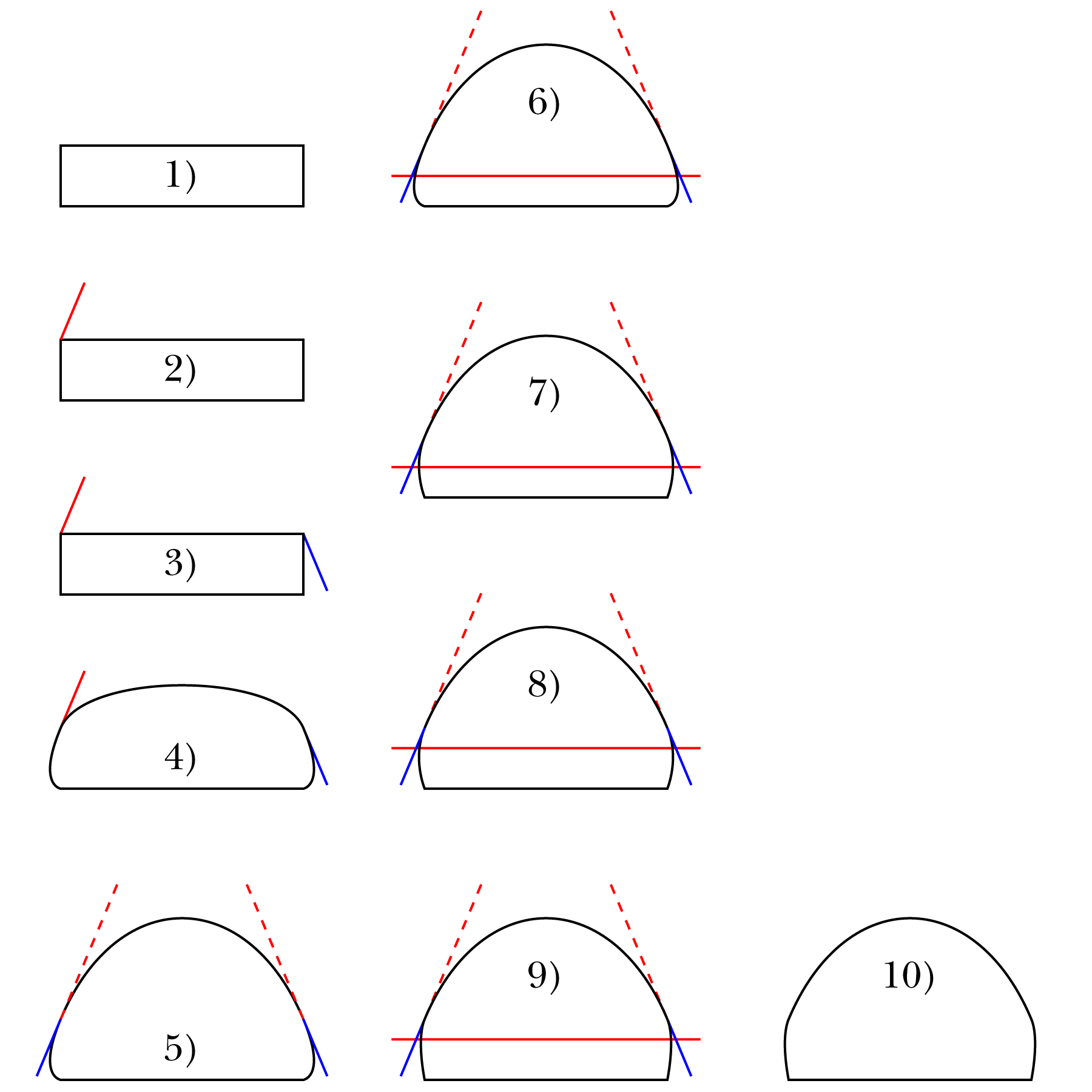

Based on my (mis)understanding that you wish to have a tight control of both shape and symmetry, working with Handles, without cutting the rectangle, here is a way with the help of the Line Segment Tool and with Smart Guides telling you when you are within snapping distance, steps shown below:
1) Create the rectangle;
2) With the Line Segment Tool ClickDrag upwards and inwards in the desired initial direction of the top curve from the top left corner Anchor Point, then change the colour of this guiding line to red;
3) Reflect the guiding line from 2) horizontally (or vertically), then ClickDrag it by its top left corner to snap to the top right corner Anchor Point, then change the colour of this guiding line to blue, then select the rectangle and bring it on top of the guide lines (you can Ctrl/Cmd + X + F);
4) With the Convert Anchor Point Tool ClickDrag from the top left corner Anchor Point to the end Anchor Point of the red guide line;
4) With the Convert Anchor Point Tool ClickDrag from the top left corner Anchor Point to the end Anchor Point of the blue guide line;
Now you have symmetrical Handles on the top corner Anchor Points and a symmetric flat top curve;
5) ClickDrag the left guide line by its top Anchor Point to snap to the top left corner Anchor Point, then change the colour of this guiding line to blue, then Direct Select the flat top curve, then ShiftClick each of the Handles or ShiftClickDrag over both, then use the up/down arrow keys to establish the desired top curve, still symmetrical;
This is the key change of shape;
6) With the Line Segment Tool create a red horizontal guide line for the bottom curves (shown half way up the rectangle), then bring it beneath everything else (you can Ctrl/Cmd + X + B);
7) DirectSelect the left lower curve, then ClickDrag the Handle along the blue guide line to the intersection with the red horizontal guide line to change the curve, then repeat for the right side;
To adjust the lower curves until satisfied:
8) Move the red horizontal guide line to a new height (shown two thirds of the way up the rectangle);
9) Repeat 7) for the new position of the horizontal guide line.
8) and 9) can be repeated until the right lower curves have been established.
10) shows the final shape opbtained in 9) without the guide lines.

You are welcome, s.
You have interpreted step 4) in my rather terse description just as I intended it.
And I agree that there are other and simpler ways without working simultaneously with symmetrical Handles.
If you can live with an Anchor Point at the top, one simple way of just drawing with symmetry that also work in CS4 is as follows:
1) Create a rectangle larger than one of the halves, thenCtrl/Cmd+C+F (hold Ctrl/Cmd and press C followed by F) to create a copy on top, then deselect and ShiftClickDrag by one of the far corners to snap so you have the two rectangles with one coinciding side;
2) Select both rectangles and Group them, then Effect>Distort&Transform>Transfor>Reflect with 1 copy, then lock both rectangles within the Group;
Now you have a frame to work within (you can set a copy aside to reuse for other mirroring tasks);
You can set the stroke to none to work undisturbed by them, relying on Smart Guides.
3) With the Pen Tool, ClickDrag (or just Click) on a suitable spot on the centre line, then drag the new path into the Group, and simply draw one half as an actual shape; as soon as you have the second Anchor Point you can (begin to see) the mirrored shape; you can use Ctrl/Cmd+Z to undo and then redo parts, and when finished you can switch to the Direct Selection Tool and adjust the actual shape and see the whole shape straight away;
4) Delete the rectangles when you are sure, then Shift+Ctrl/Cmd+G to Ungroup.
