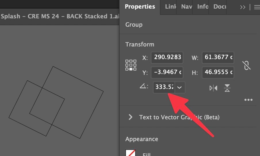

How do I access the rotation angle of an object, specifically a group, via script? I've tried BBAccumRotation tag and selectedObject.rotation, but I keep getting errors. I know the value exists in Illustrator as shown in the Properties tab:
Screenshot 2024-04-29 at 11.22.29.jpgexpand image
I'm trying to write a script that take the rotation value of a selected object and applies the negative of that value to the second selected object.
All help appreciated. Thanks!

I think a group doesn't have a BBAccumRotation tag , but paths within a group do.  Assuming that paths within a group will have the same tag, you can access the first one (selection[0] is a selected group):
alert(app.selection[0].pathItems[0].tags[0].name + ": \
" + app.selection[0].pathItems[0].tags[0].value * 180 / Math.PI);
(Courtesy of Silly-V).

Great! That seems to return a proper value...
Would you be so super kind as to help with the rest of the script? I'm a total scripting hack and while I can generally read what's going on I'm having a hard time getting it to work. This is what I was dealing with previously from ChatGPT:

Note that "the first selected object" refers to the topmost of the two selected objects.  (If this doesn't have a rotation tag, an error will occur.)  If you want it the other way around, swap the 0 and 1 in doc.selection[0] and doc.selection[1].

!! Awesome! That works great! Thank you so much. This will save me time as this is a often repeated step in a production path for fabric panels I deal with all day =]
One last thing... I noticed that the second object, after being rotated, does not show a rotation value in the properties panel. I usually use this to set the rotation back to zero after applying some other processes to that object. Any idea how to apply the rotation so that it shows as a property?
