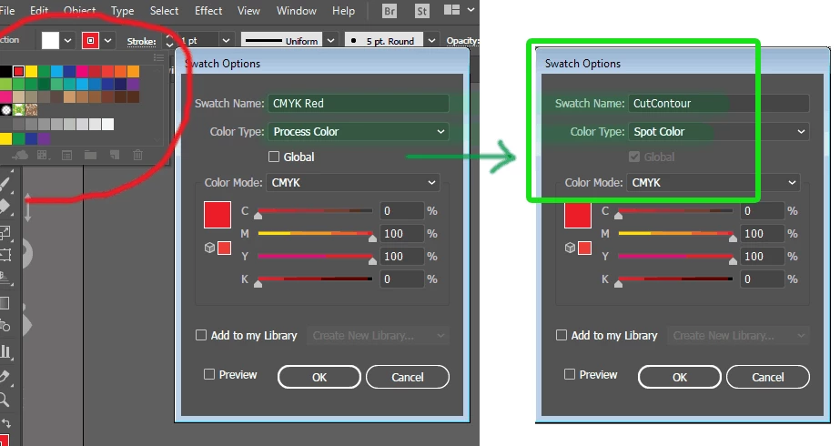

Hello! I'm looking for a script that will add a sample named "CutContour" and color type "Process Color" This is important because creating vector files that contain cut boundaries added in strokes to a Roland Printer. Thank you!

I'm adding my main tools and commands to a single Panel that I'm still building, and one of the commands I'm trying to create is adding a color that contains that ID "CutContour" will be through that ID that an Action will identify that color:
I made a short video showing how this works manually:
What I would like to find is a script that automates that process from "0:57 minute to 1: 4 minute" of the video. Thanks in advance!

Hey that's really cool, I used to do this kind of thing in my past job. You probably have what I did - a decal-making action in the works - mine copied the art 3 times and made it go into separate layers, one for the bleed, one for the art and one for the cutline. Using pathfinder I'd make all the stuff - but it reminds me of the method I used to create the CutContour swatch: in my action I had a place command which placed a little .ai file on whose artboard was a shape containing my swatch. It would automatically appear in the document when placed. So the action would place and immediately delete the document but my swatch would stick around. Just reminiscing..

By the way, do you mean "Spot color" instead of "Process" ? Cause it seems like you are starting out with Process and then change it to make it Spot.
