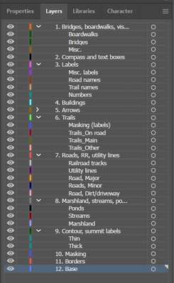

Hi all,
I'm trying to do something that I would think would be very simple, but I've walked a couple of videos now and have scoured the forum and have come up empty-handed. How can I change a sublayer to a layer and then have it in the correct order? Here's a screenshot:
I'm trying to get layer 8. Marshland so that it will be under layer 7. Roads but not nested under 7. Roads. I would think that would be really easy to do, but I've spend half an hour so far, fruitlessly dragging it, using Ctrl and Shift and various combinations, but so far I can only do one of two things:
a. Move 8. Marshland to the very top of the list, above 1.
b. Make 8. Marshland a sublayer of 7. Roads.
What am I missing? I hope I don't need to install a script or something like that for what seems like such a basic thing to do. Thanks in advance!
-- Bill

Dec 10, 2021 Dec 10, 2021
Certainly seems odd. I can (initially at least) drag a sublayer to any position except below the layer it came from -- if I do that, it becomes a sublayer again.
What I can do to get around this: Drag the sublayer to the top of the list (or anywhere else), drag layer 7 to another position (the bottom perhaps), drag the sublayer to the correct position, then drag layer 7 back into the correct order.

Thanks for the quick reply! Alas, I tried those instructions, but that left me with this, where 7 and 8 are now sublayers of 9:
Any other ideas out there? Thanks!

I tried to come up with a demo situation equivalent to yours. Here I want to move Layer3 from a sublayer to a main layer below Layer2:
As you said, I can only drag it somewhere away from Layer2, so I drag it to the top for simplicity. At this point, if I try and drag it to the correct position, it just becomes a sublayer of 2 again -- but not of any other layer. So I drag Layer2 out of position, in this example to the bottom:
After that, I can drag Layer3 in between Layer1 and Layer4, then drag Layer2 above it. Now I have the correct order:
Participant ,
Ah, thank you, Doug!
I have no idea why that worked, and it didn't work at first, but eventually, I was able to drag everything to the bottom, and then reconstruct the list of layers in order from there:
Ah, I can rest easy now. Thank you!
-- Bill

Mar 04, 2022 Mar 04, 2022
Hi all,
I've just discovered an easy fix to this problem I asked about a few months back, where I was trying to change a sublayer to a layer. The easy way is to lock all the other layers, then move around the offending sublayer. You can move it to the top, then move it to wherever you want it to be among the other layers. Here's a screenshot to show you what I'm talking about, with the original at the top and the new, improved layers on the bottom. I know the numbers are out of order, but that's okay.
-- Bill
If the area you want to drag the sublayer to is below an expanded layer, AI will make it a sublayer under the new location. If you collapse the other layer, it can drag it below it.
Expanded Layer:
Collapsed Layer:

Had the same issue. you have the layers Expanded so he thinks you want to drag it below a place inside the layer. to fix:
  1. move the layer to the top or bottom.
  2. Collapse all layers by using the arrow button so it hides the content inside the layers.
  3.  move the layer to the position you want.
all actions are in the layer tab from adobe illastator.
