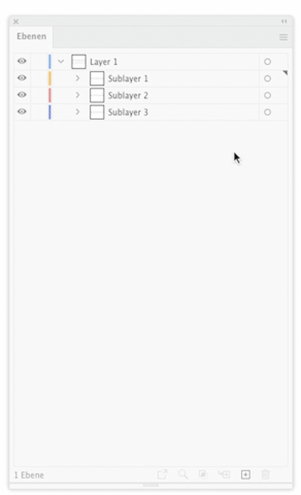

Selected or highlighted main layers and sublayers are marked with a tiny triangle at the top-right corner of the layer entry. Groups and single objects don't have that label. You may check that.
