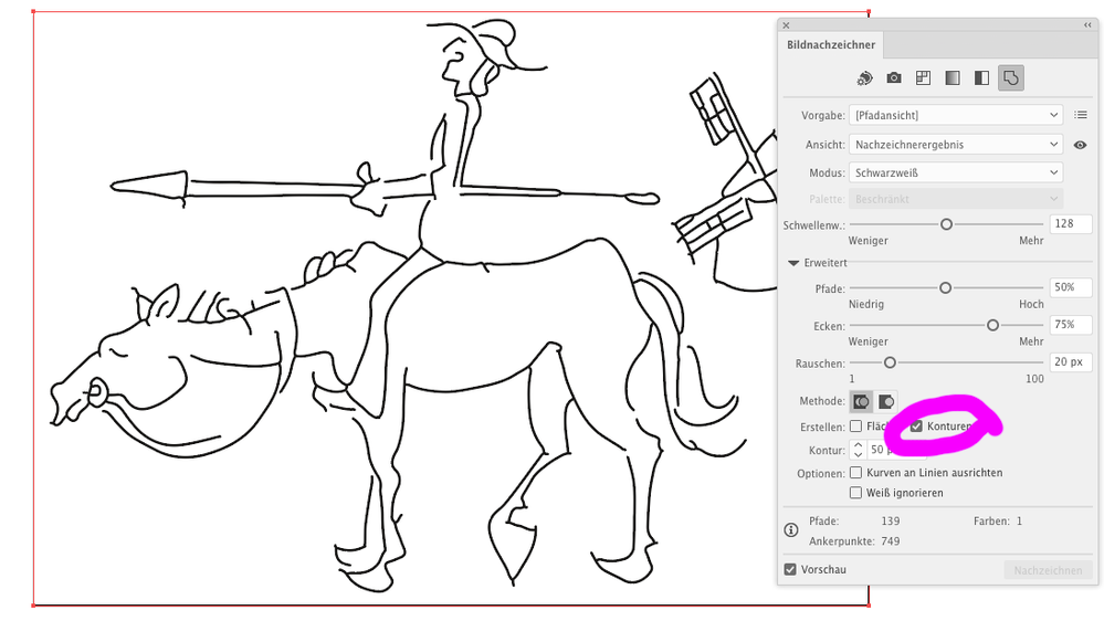

If you want to try:
Might get slightly better with more precision, but then that's it.
There is this trick with using a blend between the 2 exsting lines, but it would require so much work that jst drawing the image manually might even be quicker. You would first need to cut the lines before you can create a blend (in order to get a centerline).
