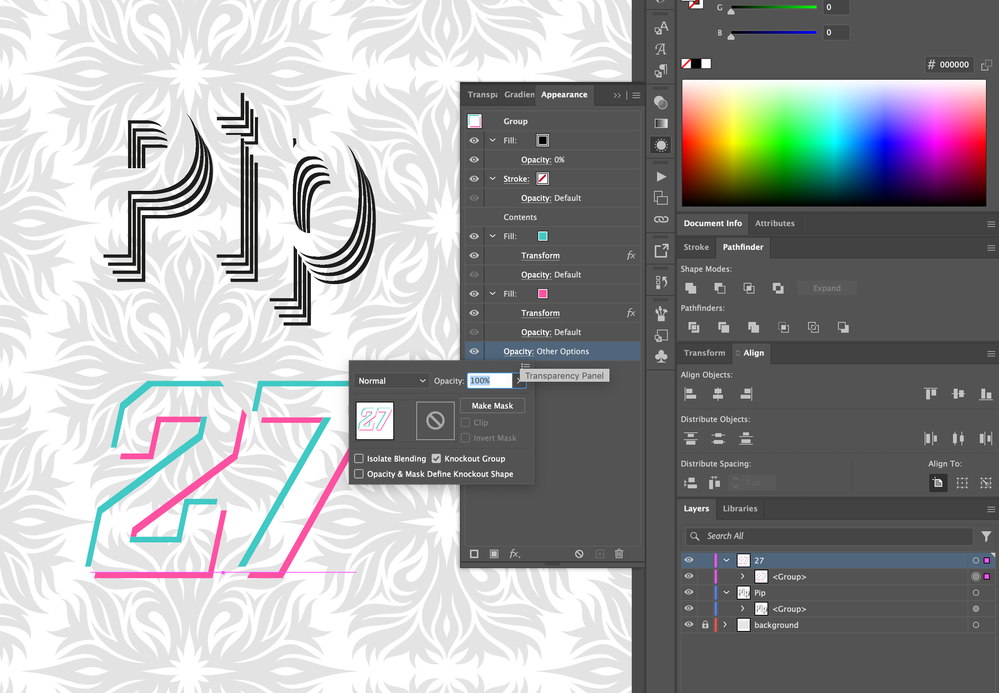

Is it possible to use the Pathfinder Extrude effect to some live type? I'm trying to acheive a blank area inside the type (see image). Where you see black in the letters, I would like that to be the dark gray background, while still being able to change the text. I've tried applying the Extrude in the appearance panel but it doesn't seem to do anything. Thanks.

You first need to turn the text into a compound shape using the Pathfinder panel.
There need to be two fills on the object,
Then apply the transform effect to shift the fills AND make a copy
Then apply Pathfinder subtract to both of the fills.
Like this: https://youtu.be/0J8bcvlPh40
Further explanation (but different example)
https://youtu.be/qeU84BPCu7c

I got it to work with info from another thread. I did not use Object Outline or Outline Stroke. I put the two fills with position transform below the Contents, then on top of the Contents I have a fill with Opacity 0%. BUT, the trick is to set the bottom Opacity to check off Knockout Gorup.

This is close, but for some reason it's not working. I have 2 fills, and I'm adding the Path > Outline Object to each fill. Then I'm grouping them. And then on the group adding a Subtract, and it's almost working. It seems to only subtract one number not both. This tells me maybe the Outline Object is not working?
