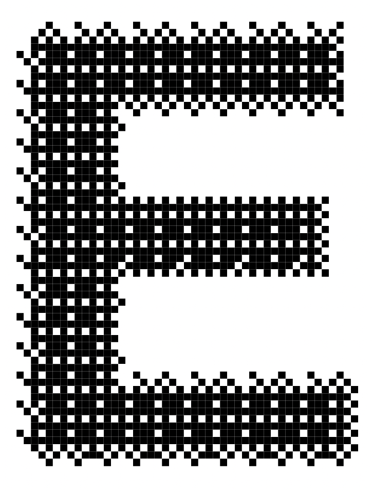

I followed all your steps but the resulting bitmap image didn't come out how I wanted. What values should I input in the halftone screen dialogue option? This is currently what I'm getting.

I played around with the halftone screen options and went for a much higher resolution output (1400.)
It's closer but still not quite the look I'm after. Is there any way white dots can be smaller and spaced further apart. At the moment it seems the spacing is too even/ as even as the size. I'd also like it to seem more 'rounded' if that makes sense. In the example, some of the halftone dots seem to stick to eachother, as if they've been stamped on physically.

"halftone screen options and went for a much higher resolution output (1400.)"
Sorry, I did not mention output resolution.  1400ppi is not enough to generate a good halftone dot.  I recommend using the "Ellipse" shape ad a frequency of around 53 lines per inch.  But, the resolution should be set to 5080ppi.  It will take a little time to render, but you should get a good shape.  It will take some experimenting to get the final look you are after.  Be aware that anything above 50% color will render a reverse dot ( white ) and anything under 50% will render a black dot.  Your color looks like around 80%, so the dot will be white.  The actual size of the dot and the amount of dots depends on the frequency of the halftone and the color tint.  Let me know if this helps and if you need any more help.
