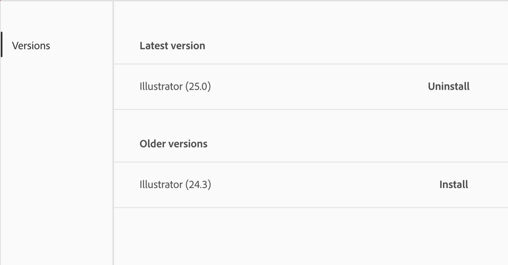

Hi I'm currently having the same issue I can't open my ai files and I also have no options of the version 24 on my creative cloud. Can u help me? thank you so much this would save my life
Screen Shot 2020-11-16 at 21.57.17.pngScreen Shot 2020-11-17 at 15.40.39.png

I'm in the same position as KYRA5FE0,
Have tried to open these files in both 24.3 and 25.0 with no luck.
Any tips for those of us who can't get to a version older than that?

Nov 17, 2020 Nov 17, 2020
Hii yess same I'm using MacBook as well this is super frustrating 😢
can anyone help us on getting the older version?

As per ryanb59064838's instructions, I installed down to 24.0 and my file was able to open no problem! It's easy to do within the Adobe Cloud.
Go to All Apps
Click the ... beside the program
Click Other versions
and Install the version down
