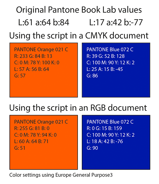

I need to create a chart that specifies just the LAB values underneith the swatches that the script creates, but curiously, the LAB values that the script produces are always wrong - they're always out by a digit and I don't know why.
If I double click the swatch in the swatch palette, the LAB value is correct/as it should be, it is just the text that the script produces and lays onto the artboard that is incorrect. Please see following image. Any ideas why this glitch is happening?
This glitch happens consistently on every single import - the lab value that the script generates onto the artboard is never the correct value. Help!

It comes down to rounding, decimals get lost from Pantone to CMYK (or RGB) then to LAB.
Participant ,
Sep 16, 2020 Sep 16, 2020
I’m not sure that is correct. Rounding would make sense if there were half values etc but this isn’t the case.
On every single imported swatch - I.e on every swatch the script runs through and presents on the art board, the values are always one digit more out, without fail. The L value often remains the same, but the A B Values are always off by one digit. This isn’t rounding, there’s something going wrong.
It is not rounding.
A Pantone color cannot be reproduced in CMYK, that's why it is a special mixed ink.
But Lab can describe any color we can see.
When you convert from Lab to CMYK you will lose color information
When you convert it back to Lab, you will never get the original values back.

Knowing what we know now, the script will only give correct values for CMYK swatches in a CMYK document an RGB swatches in an RGB document. All other values are calculated using the current color settings.

Yes as far as I can conclude, the RGB values that the script gives you are the same values you would get when you open the Pantone swatch and manually switch to RGB.

Let me add to my latest reply: the RGB values that the script gives you are the same values you would get when you open the Pantone swatch and manually switch to RGB: In an RGB document.
You did it!
The Lab values are exactly the same as the ones from the Pantone swatch.
And in an RGB document the RGB colors are the same as the conversion you see when you select RGB in the Color panel or in the Swatch options.
Same for the CMYK conversion in a CMYK document.
But CMYK or Gray numbers are totally different from the conversion you would expect when you selected them in an RGB document and RGB and Gray are different in a CMYK document. I wonder where that comes from.
