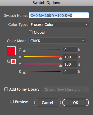

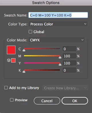

When I'm in the Illustrator Swatches panel, I can double click on an existing CMYK colour swatch and view options for it in the Swatch Options panel.
The Swatch Name comes up as the relevant CMYK values and the 'Colour Type' drop down menu defines it as a Process Colour.
Colour Mode is CMYK. Everything is as expected.

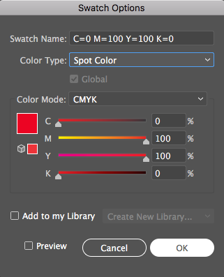

Under the 'Colour Type' dropdown menu, I can change 'Process Colour' to 'Spot Colour.'
When I do this, Colour Mode remains set to CMYK (although can be changed to Grayscale, RGB, HSB, Lab or Web Safe RGB)
I find this odd, as I wouldn't normally think of any of the above as being directly connected with choosing Spot Colours
(other than converting from Process colour to Spot colour)
When I changed the Colour Type to Spot Colour I assumed I would see some sort of conversion mechanism, offering to try and convert the CMYK colour to the nearest colour book colour e.g. a Pantone colour.
Or perhaps a list of the colour book types available from the Swatches Panel corner menu > Open Swatch Library > Colour Books.
(I realise these options bring up a new window full of the selected Color Book's colours along with the associated ink names and these can be dragged into the main Swatch panel)
Having made the change from a CMYK swatch into a Spot Colour swatch via the Color Type dropdown menu, I can then 'OK' this window to close it.
The Swatches panel displays the selected (previously CMYK) swatch but it now has a circular icon to indicate it's a Spot Colour. So I would assume Illustrator now regards this colour as a Spot Colour and no longer a Process Colour.
However when I move my mouse over it, or double click to open the Swatch Options, the Swatch in question is still referred to by it's CMYK colour values, and looks exactly as it did previously.
If the colour has indeed been changed from a CMYK swatch to a Spot Colour swatch, I have no way of knowing which book the Spot Colour is from in order to communicate this to a commercial printer.

    Correct answer JETalmage
    I'm still unclear on what is actually being done when I make this change in the Swatches panel.My previously CMYK colour…a CMYK swatch (a red colour in this case)…is now regarded by Illustrator as a Spot colour…So some kind of change has taken place - from CMYK to Spot.
    Right. 100M, 100Y. That's as "red" as red gets in CMYK process printing: Magenta and Yellow printed as solids (no tone dots).
    It's a prime example of what I said about process-to-spot not being the exacting 1:1 correspondence many think it to be. It is also simply not true that "all colors can be made by mixing process C, M, Y, and K." Far from it. There is a whole world of colors that cannot be "matched" in 4-color process. That's one reason why spot inks exist. Examples:
    • Pantone 185C is a very common choice for a "very red" red. One could say it is actually "redder" than the "reddest" you can mix in CMYK process inks. How? Because there is more to "color" than just hue (yellow, red, purple, etc., etc.) There is reflectance. Chroma. Even luminescence. Pantone's Spot to Process color guides specify significantly less than 100% of M and Y in order to simulate 185C. And that mix falls far short.
    • You can try all varying percentages of Y and M and you are never going to get school bus yellow.
    • And most of all, you are never, ever going to get "sky blue" from any tint of Process Cyan, because of the four process inks, Cyan is the weakest.
    When designing for print, forget "color." Think "inks."
    What's being done is exactly what I said: Defining a Swatch as Spot simply tells the program to create a separate grayscale color channel (color separation plate) labeled by that Swatch's name. That's it.
    Suppose your project is a brochure to be printed on a commercial sheet-fed offset press. So you set it up as CMYK (four inks).
    In order to print that file, it has to be color separated; imaged as a set of individual films (or plates); one for each ink. Software first creates one image (channel) for each ink:
    • An image for Cyan ink
    • An image for Magenta ink
    • An image for Yellow ink
    • An image for Black ink
    Did you catch that? Each image is just a grayscale image. There is no color involved.
    Each of those channels is then individually screened by the Raster Image Processor into a bitmap; an array of tiny solid black dots. That's what actually gets printed to the film (as a negative) or directly to the plate (as a positive).
    Again, catch that: Now there are not even any grayscale tones. Each channel has just become a bitmap; a 1-bit image; it's all just "pixel on" or "pixel off." An offset press doesn't print "tones" of ink. It either prints "ink" or "no ink."
    But suppose the client's logo color specification is a particular spot color, Pantone 185, and the client wants it that color; not a mere approximation of it. (The four color process brochure has now become "process plus 1.")
    So you define a new Swatch, tediously adjusting whichever color mode of sliders and fields you want, calling upon all the extraordinarily sensitive artistic discernment you can muster in order to simulate on your monitor what you think looks as precisely close as possible to the color of Pantone 185 ink.
    But fact is, as soon as you tell the program "I want this to be a Spot Swatch", the color settings you've been sweating blood over really mean absolutely nothing. Neither the program nor the pre-press imaging process is going to "mix" the ink for you. The pressman is going to pull it off the shelf and load it into the inkwell, just like he does with Cyan, Magenta, Yellow, and Black process inks.
    By setting the Color Type to Spot you've just told the program, "This Swatch represents another separate ink. It is not to be color-separated into CMYK. So anything colored with this Spot Swatch shall not appear on the C, M, Y, or K plates. Everything colored with this Swatch is imaged in one additional single grayscale channel which is merely labeled 'Pantone 185.'"
    So when the printing house receives the file he images it as color separations, just as before, but this time gets 5 plates, again one for each ink:
    • An image for Pantone 185 ink
    Here's the thing:
    You could have "mixed" the displayed color of the "Pantone 185" Spot Swatch using 100M and 100Y  (as you did, and as I would). It doesn't matter one whit whether that is what Pantone Inc recommends as the "best" CMYK simulation for that Pantone ink.
    In fact, you could name that Swatch "Pantone 185" but edit its color to look like my Muddy Orange on the monitor. It would not change how the extra separation plate images at all.
    You could also have forgotten to name that Swatch "Pantone 185." If you had, the program would have left its name "C=0 M=100 Y=100 K=0", and functionally, that also wouldn't change a thing. But you'd probably get a call from the printing house asking, "What ink do you intend to use for this spot color. Or did you make it a spot Swatch by mistake?"
    You could go back and rename that Spot Swatch "Peter Pan One Eighty Five" and that wouldn't matter one whit, either. The spot color that prints is simply a matter of what color ink the pressman loads into the inkwell for that separation plate.
    There is no programmagical "link" between how you color your on-screen simulation of a Spot Swatch and the ink that the pressman loads. It's just a piece of information that needs to accompany the job.
    Above are screenshots from the Swatch Options having double clicked a CMYK swatch (a red colour in this case)
    The panel itself uses the term: "Color Type" and lets you select from either Process or Spot (as above)
    And below it uses the term "Color Mode" and lets you choose from CMYK / RGB / Grayscale etc etc etc
    When I click OK, the window closes and I see this.
    My previously CMYK colour (red at lower left) is now regarded by Illustrator as a Spot colour according to the Spot Color icon which has appeared in its lower right corner.
