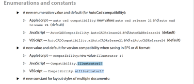

Community Expert , Jun 11, 2020 Jun 11, 2020
I see the option is available at the link you specified but it does not work for me too. But I have one document "Adobe Illustrator Script Guide 2020", which does not have this value. Attached is the document. You can check the latest value added as ILLUSTRATOR17 on page 12 of the document. Attached screenshot from that page.
Link to the file
Scripting Guide 2020
Link to the file

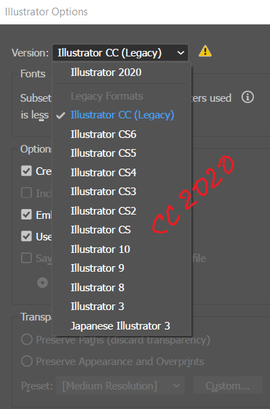

Anything to do with the drop down listing CC Legacy as a file specification?

The latest Scripting Reference lists ILLUSTRATOR17, ILLUSTRATOR19, and ILLUSTRATOR24 as options.
I'm not sure how that marries up with CC (Legacy) in the UI. That implies it covers both v17 and 19. I wonder what differentiates those?

ok, digging around a bit...
in CC2019 there was no such thing as Legacy format, we could only save as CC or down to each CS version. So, there was no matching compatibility specifically for CC2014-CC2018 in the API.
Illustrator CC = Compatibility.ILLUSTRATOR17;
Illustrator CS6 = Compatibility.ILLUSTRATOR16;
now that we have Legacy format, CC2020 became version 24 and all previous CC versions kept v17.
Illustrator CC2020 = Compatibility.ILLUSTRATOR24;
Illustrator CC Legacy = Compatibility.ILLUSTRATOR17;
