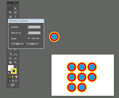

I need a preview before it clicks "ok" when checking the checkbox. But I appreciate your effort.
Advocate ,
Aug 11, 2023 Aug 11, 2023

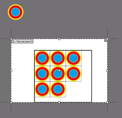

Damn! This is fantastic. Worked perfectly. I was having a lot of trouble doing this. Helped me a lot. Now a doubt and a curiosity. The question: could the preview be updated just by typing "TAB" in the quantity and spacing? I noticed that it only updates if I uncheck and recheck the checkbox. Curiosity: in what sense could it be more refined? Thank you very much.
Advocate ,
Aug 12, 2023 Aug 12, 2023
Bonjour,
Décocher vous permet de modifier les valeurs quantité et espacement.
OK pour valider.
René
PS On peut toujours faire mieux, je n'ai pas le temps pour cela...
La question: l’aperçu pourrait-il être mis à jour simplement en tapant « TAB » dans la quantité et l’espacement.
Réponse: certainement.
Advocate ,
Aug 22, 2023 Aug 22, 2023
Bonjour Marcos,
Une solution qui semble fonctionner comme tu l'entends.
René.

  var regPref1 = /^[\d]{1,5}$/; // del 1 a 5 Figuras
  var regPref2 = /^[0-9.-]{1,15}$/; // del 1 a 15 Figuras
  var sel;  // Objeto selecionado
function main() {
    if (selection.length > 0) {
      var sel = selection[0]; // Objeto selecionado
          app.selection = null; // alert(sel)
          createDialog(sel);
    else {
      alert("Selecione pelo menos um objeto!.");
 if (app.documents.length > 0) {main();}
 else {alert("Um documento deve ser aberto e um objeto selecionado!");}
function createDialog(sel) {
  var res = "dialog { \
      txt: '', \
      orientation: 'column', alignChildren: 'left', \
      properties:{ closeButton: false }\
        addr1: Group { orientation: 'row', \
          s: StaticText { text:'cantidad:' ,characters: 15 }, \
          e: EditText { preferredSize: [80, 20]}, \
        addr2: Group { orientation: 'row', \
          s: StaticText { text:'' ,characters: 15 }, \
          e: EditText { preferredSize: [80, 20] }, \
        v: Group { orientation: 'row', \
          s: StaticText { text:'Visualiz', characters:15 }, \
          vckbox: Checkbox { text: ' - Click Test -' } \
        btnPnl: Group { orientation: 'row', \
          okBtn: Button { text:'OK', properties:{ name:'ok' } }, \
          cancelBtn: Button { text:'ESC', properties:{name:'cancel' } } \
  var w = new Window (res);
      w.location = [100,300];
      w.text = title;
  var e = w.addr1.e; e.text = q;
      e.active = true;
  var b = w.addr2.e; b.text = g;
      w.addr2.s.text = "Calha em " + monUnit+ ":";
  var vb = w.v.vckbox;
  var mode = false;
  var er = false; //
         e.onChange = function () {
           if ( e.text*1 != q) {
              er = init(); mode = true;
          if (vb.value && !er) {
            refrech(sel);
            traitement(sel,X0,Y0,XD,q,g,unit,unitPos,geom,wAb,wCt);
            redraw();
            e.active = true;
        b.onChange = function () {
           if (  b.text*1 != g) {
            refrech(sel);
            redraw();
            e.active = true;
        vb.onClick = function() {
          if ( vb.value ) {
            er = init();
              if ( !er ) {traitement(sel,X0,Y0,XD,q,g,unit,unitPos,geom,wAb,wCt);}
            redraw();
            e.active = true;
          else  {
            refrech(sel);
            er = init();
            e.active = true;
        w.btnPnl.okBtn.onClick = function () {
          mode = false;
          if ( e.text*1 != q ||  b.text*1 != g ) {
          if (!er) {
            if ( !vb.value ) {traitement(sel,X0,Y0,XD,q,g,unit,unitPos,geom,wAb,wCt);}
            else if ( mode ) {
              refrech(sel);
          w.close();
        w.btnPnl.cancelBtn.onClick = function() {
            if ( vb.value == true ) {
              refrech(sel);
              sel.selected = true;
          w.close();
        function init() {
          var er = false;
                if (saisie(e.text,regPref1) && e.text != '0' ) {q = e.text*1;}
                else {beep(); er = true;}
                if (saisie(b.text,regPref2) ) {g = b.text*1;}
              return er;
        function refrech(sel) {
          app.executeMenuCommand("undo");
          redraw(); sel.selected = false;
w.show();
function prop(Bounds) {return [Bounds[2]-Bounds[0],Bounds[1]-Bounds[3]];}
function saisie(chaine,reg) {
   if (reg.test(chaine)) return true; return false;
function traitement(obj,X0,Y0,XD,q,g,unit,unitPos,geo,wAb,fixe) {
  // Define a posição do objtet[0] selecionado em relação à prancheta
      g *= unit;
  var doc = app.activeDocument,
      vBs = !geo  ? obj.visibleBounds : obj.geometricBounds,
      propi = prop(vBs),
      W = propi[0],
      H = propi[1],
      difw = (W - obj.width)/2, //pt
      dec = W + g,
      idx = doc.artboards.getActiveArtboardIndex(),
      ab = doc.artboards[idx],
      rect = ab.artboardRect,
      posX = rect[0] + X0 * unitPos + difw,
      posY = rect[1] + Y0 * unitPos - difw,
      posXAtual = posX,
      posYAtual = posY,
      wCont = wAb ? rect[2] : rect[0] + fixe;
      grd = doc.groupItems.add();
        for (var i = 0; i < q; i++) {
          if ( (posXAtual + W - difw) > (wCont - XD*unitPos)) {
            posXAtual = posX;
            posYAtual -= H + g;
          var novaCopia = obj.duplicate(grd);
              novaCopia.position = [posXAtual,posYAtual];
              posXAtual += dec;
Explorer ,

Thank you for your commitment. The previous code served well. I'm still trying to improve it. That last one sent didn't work.
Advocate ,
Aug 23, 2023 Aug 23, 2023
J'ai testé le dernier script sur Illustrator CS6, il fonctionne.
Quel est le problème pour vous, il se passe quoi ? (la boîte de dialogue s'affiche en haut à gauche [100,300] ?)
René.
Explorer ,
The dialog appears normally, but the preview doesn't work and neither does the distribution when I click "Ok". Nothing happens.
