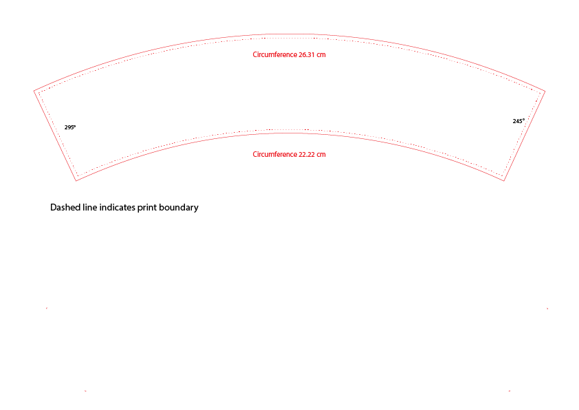

A new pdf is attached for your reference. The keyline drawing is exported from Autodesk Powershape which is used to create the 3d  container model for machining. The attached drawing is in relative proportion. I have marked the details that I understood from your reply.

Explorer ,
Mar 22, 2021 Mar 22, 2021
Sir,
Various types of the same file are attached for your reference

Vishnu,
As far as I can make out, to get it right you can start out with a rectangular label (the full label) with about W = 24.27 cm and H = 4.69 cm. Hopefully you already have that.
And I believe you can get the right (un)distortion if you:
1) Scale the full original label by 88.6% (leave the height unchanged) corresponding to W = 21.5 cm (with the measures above),
2) Apply Effect>Warp>Arc with a Bend of 27.778%.
Explorer ,
Mar 27, 2021 Mar 27, 2021
Sir,
Thank You for your support.
The above methods do a perfect job.
