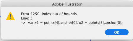

i have an error. dosn't work.

Okay I understand why it did not work. (According to what you explained).
Now it works but: The calculation is incorrect. When the rounding is 5, it gives a very high number. please check.

The result you get is a pt-value ... you have to convert it into mm.
// select round-cornered rectangle
var points = app.selection[0].pathPoints;
var x1 = points[4].anchor[0], x2 = points[5].anchor[0];
var y1 = points[4].anchor[1], y2 = points[5].anchor[1];
var rect1 = app.activeDocument.pathItems.rectangle(y1 + 20, x2 - 60, 50, 20);
var text2 = app.activeDocument.textFrames.areaText(rect1);
text2.contents = +(Math.round((Math.abs(x1 - x2)*0.352777777)+ "e+3")  + "e-3") + " mm";
text2.contents = "r " + text2.contents;

Hi @femkeblanco and @Tom Winkelmann
A side note:
You both use the wrong path points for calculation.
In this case:
instead of:
use:
var x1 = points[3].anchor[0], x2 = points[4].anchor[0];
var y1 = points[3].anchor[1], y2 = points[4].anchor[1];
But this will only help in this special case. Try not to rotate or mirror the rounded rectangle!
As I wrote at the beginning of this thread: A lot more math is required.
First you need to identify the two path points in the upper left corner. Then use these path points for your calculation.
