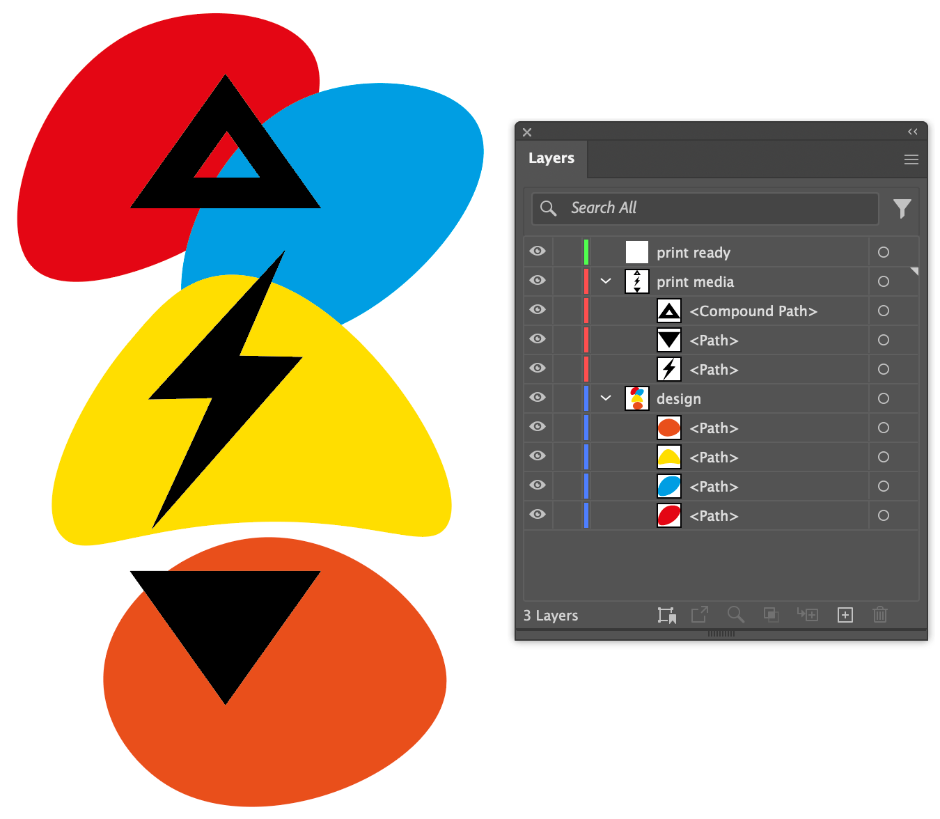

Hi everyone,
I’m currently working on a project in Adobe Illustrator and could really use some help. I want to automate a repetitive workflow that involves:
  1. Copying the artwork (design) from a layer called “design.”
  2. Going through each path (or compound path) in a layer called “print media.”
  3. For each path:
    • Pasting my design in place behind it.
    • Creating a clipping mask (where the path is the mask and the design is the content).
    • Making sure the finished mask stays in the exact same position as the original path.
    • (Optionally) moving the final clipped artwork to another layer called “print ready.”
I’ve tried several JavaScript/ExtendScript approaches, and I’ve learned the following:
  • The path must be on top (in z-order) so Illustrator recognizes it as the mask, rather than the design.
  • If the path is inside a group, sometimes Illustrator treats the whole group as part of the mask, which isn’t what I want.
  • When there are multiple paths, I want to make sure each one becomes its own clipping group—no combining multiple paths into a single clip group—and that each path ends up correctly masked with the design.
  • Sometimes the position of the clipped group shifts if Illustrator is handling transformations or bounding boxes differently.
Despite trying various code snippets and suggestions (including collecting all the paths in an array before looping, making sure to bring each path to the front, and so on), I’m still running into issues:
  • Illustrator occasionally reuses the same path for multiple masks, or merges them into one large group.
  • Sometimes it misplaces the final mask so it no longer lines up with the original path position.
  • Compound paths (“stansade banor”) especially like to combine or behave unexpectedly.
Any tips, scripts, or pointers you can share would be greatly appreciated! Thank you so much in advance—I’m really hoping there’s a tried-and-true approach to simplify this workflow.
Cheers,
K
Correct answer m1b
Ah @kalle27850504iimx that's exactly what I needed!
Here's a script that will (I hope!) do what you want. It works on your sample files at least. Actually I made one of your masks into a compound path item because they are more difficult to work with. Let me know how it goes.
- Mark

Hi @kalle27850504iimx, could you please post a demo file (save as pdf with illustrator editable) that shows before and another demo file showing after running the hypothetical script? This is the best way to show exactly what you want the script to do.
- Mark
January 14, 2025
Hi Mark! Thanks for answering.
Here’s a detailed rundown of what I’d like the script to do in Illustrator:
Copy all the artwork from a layer called “design.”
In the layer “print media,” loop through every path (including compound paths). For each path:
Paste the copied design behind the path (i.e., “Paste in Place” but behind in z-order) so it occupies the exact same coordinates as the path.
Create a clipping mask where the path is the mask, and the pasted design is the content.
(Optional) Move (or cut/paste) the newly created clipping mask into a layer named “print ready” while keeping the same position, if possible.
Repeat the above until all paths/compound paths in “print media” have become clipping masks.
m1b
m1bCorrect answer
Braniac
January 15, 2025

 * @returns {Array<PageItem>}
function getIntersectingItems(items, bounds, useGeometricBounds) {
    var found = [],
        boundsType = true === useGeometricBounds ? 'geometricBounds' : 'visibleBounds';
    for (var i = 0; i < items.length; i++)
        if (boundsDoIntersect(items[i][boundsType], bounds))
            found.push(items[i]);
    return found;
 * Returns true if the two bounds intersect.
 * @author m1b
 * @version 2024-03-10
 * @param {Array} bounds1 - bounds array.
 * @param {Array} bounds2 - bounds array.
 * @param {Boolean} [TLBR] - whether bounds arrays are interpreted as [t, l, b, r] or [l, t, r, b] (default: based on app).
 * @returns {Boolean}
function boundsDoIntersect(bounds1, bounds2, TLBR) {
    if (undefined == TLBR)
        TLBR = (/indesign/i.test(app.name));
    return !(
        TLBR
            // TLBR
                bounds2[0] > bounds1[2]
                || bounds2[1] > bounds1[3]
                || bounds2[2] < bounds1[0]
                || bounds2[3] < bounds1[1]
            // LTRB
                || bounds2[1] < bounds1[3]
                || bounds2[3] > bounds1[1]
