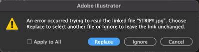

Jul 05, 2023 Jul 05, 2023
Having the same issue also, I also get this error message. Hope they fix it soon. 

This happens to me EVERYTIME I open an illustrator file. It happens even when I have no other files open (as some people have stated might be a workaround). It's so frustrating hving to spend 10+ mintues cleaning up the file and relinking before I can even do any work on it.
It seems that all the links get placed multiple times and enlarged over my artboards. I always get the same error message. And then my accurately placed links become pixelated and have several duplicates sitting on top of each of them. See attached screengrabs.
