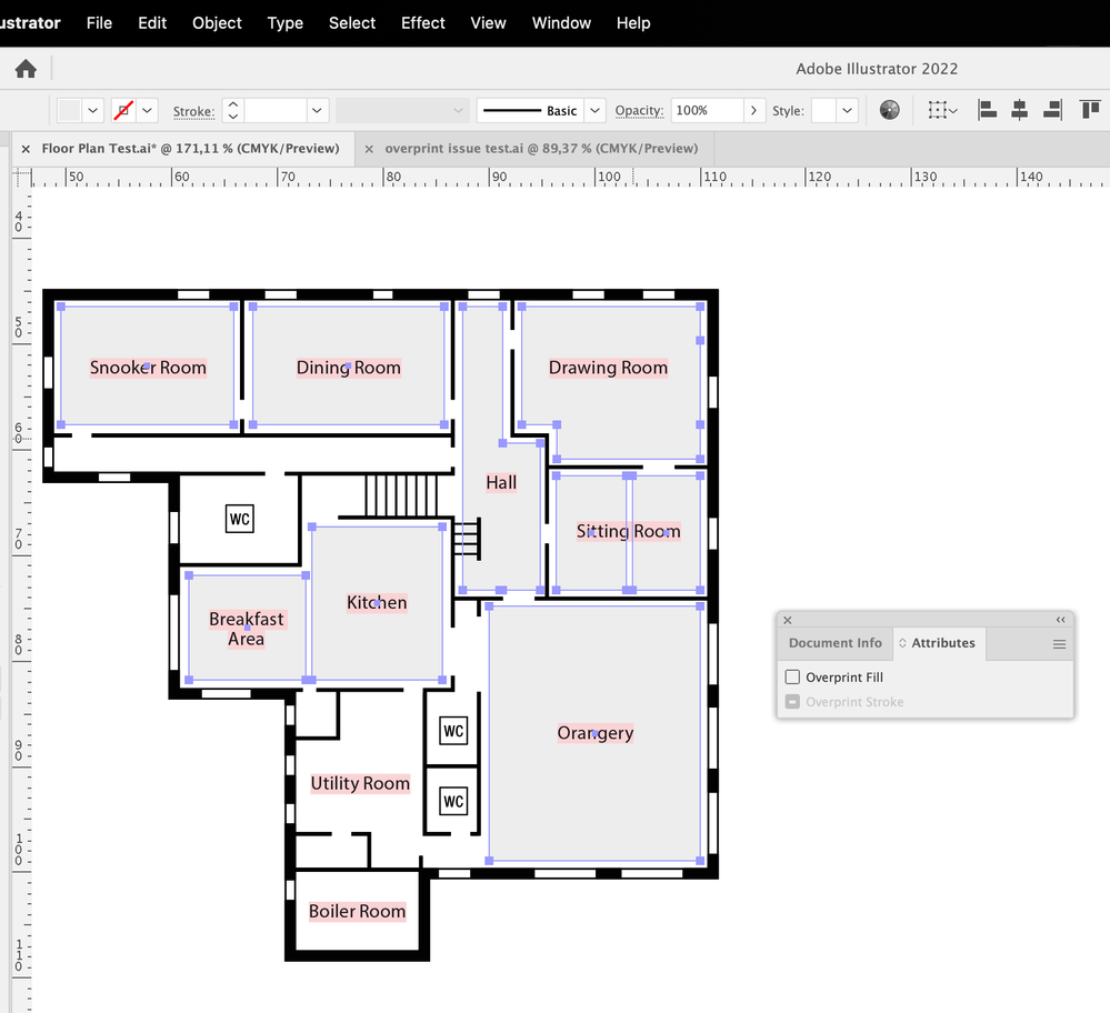

OK … so today I've opened a complex floor plan (a file I've previously worked on without any knowledge of an overprint issue … which isn't to say 100% there wasn't one … but I don't think so).  Once opened, I've done a 'Select All' and the Attributes panel highlights that some items have 'overprint' applied (both 'Overprint Fill and Overprint Stroke have a dash in the box to indicate 'some layers' have it applied).  If I click both these boxes, the dash becomes a tick (so now everything has overprint applied).  Now I click again on each box to switch overprint off for all elements on the page.  I deselect all objects, then 'select all' again, only for the dash to reappear indicating overprint is back on, on some objects.  Any thoughts on what would cause that?  I've stripped the file down to make much more simple, and recorded my screen to demostrate (see attached).

So far the display in the Attributes panel is normal. When there is no fill on the object, there is a strikethrough.
In your situation this is getting so difficult to check, because your black is a muddy black. It's been set up in RGB. Same goes for the color objects.  So usually for check the overprint you could just turn off the black (or other single inks) in the Separations panel and you know whether it will overprint. Overprinting objects that have more than one single ink applied is usually problematic (which might be why you are asking about this in the first place). Could it be that the artwork originated in a CAD application? Because that would somewhat explain the swatches setup in RGB.

Hi Monika … thanks for coming back to me, and for taking a look.  Yes, the floorplan is originally from CAD (muddy black) … and (as you say) it highlights the difficulty I'm facing in other complex (colour rich) logos/illustrations etc. where overprint appears to be applied to some random layers.  Thanks for highlighting the 2 plugins, I'll explore these (at least for identifying problems areas).  Being able to group select (stroke or fill objects only) whilst really useful (good to know this exists), won't solve the problem of applying overprint to all, only to reselect and discover its turned itself off again (as per my 'squares' file).  All massively problematic.  Yesterday I had a situation where 5x black (100% K) were overprinted (as desired), but one was randomly knocking out the image behind (once brought into Indesign).  On inspection, and playing with the 'Edit/Edit Colours/Overprint Black' feature, I got a message saying the selected object wasn't 100% black (it was!).  I ditched the colour from the palette and create a new one, applied this, and then it was happy!! It could be user-error on my part, but I think there's a bug in the system.  I will see what today's jobs present.

Hi Monika … I agree … I don't want to be using overprint.  I'd be very happy for nothing (within Illustrator) to overprint.  Illustrator appears to be applying the setting to random layers (as per my original post).  I'm just trying to identify the layers where it's turned on and turn it off. Within Illustrator, when I do this, it comes back on (as per my video demostration). This is the problem (possible software bug) I'm reporting (as per my video with the 6 coloured squares).

Hi Monika … thanks for the video (and your time generally).  I see this worked as expected.  I can mimick the same this end and it's working well (today!).  I've just installed the 'Select Menu' plugin which seems really good … I suspect this will be a great aid identifying future instances.  I've got a better understanding now of the dash symbol in the overprint (fill/stroke) 'tick boxes' … I'd previously understood a dash to mean 'some items selected have function applied' … I now understand it can mean some items selected don't have functionality for the function (which is subtley difference, but significant in this case). I'm still unclear why I'm receiving mutliple logos with overprint within them (I've been designing for 24 years without a problem and had 5 instances within last few weeks, each from different suppliers).  I will continue to monitor the situation.  Thank you so much for your time and assistance  🙂

I've done a little test.  When I select an object with a fill (and no stroke), the fill shows as 'no overprint', but the grayed-out 'overprint stroke' has a dash.  When I select an object with a stroke (and no fill), the stroke shows as 'no overprint', but the grayed-out fill shows a dash.  Select both objects and both 'overprint fill' and 'overprint stroke' illuminate (i.e. can be edited), both with a dash, suggesting one of the elements has overprint applied, when it fact it isn't.  However, if I now edit these (turn both on or off), when I deselect and reselect, it defaults to a dash, making it very unclear if there genuinely is an overprint applied or not.  Am I doing something wrong or misunderstanding the function somehow?  (see attached video).
