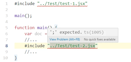

In Visual Studio Code in the jsx file on all lines where #include is used, it gives a problem and suggests using ‘;’ at the end of the line.
What is causing this to happen?
Correct answer sttk3
Writing `//@include` instead of `#include` will prevent the error.
//@include '../Test/test-1.jsx'
main() ;
function main() {
  // do something
sttk3Correct answer
Braniac
January 12, 2025
main() ;
function main() {
  // do something
January 12, 2025
Well, commenting on a line is clearly not a solution to the problem...
Braniac
January 12, 2025
Have you actually tried this method? The code will be imported. Or is it not your goal to avoid errors and include the code?
