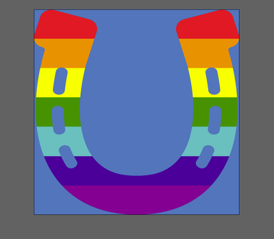

I have a horseshoe that was originally an EPS but I turned into a compound path per advice of @Bobby Henderson to be able to "punch out" pill-shaped holes. So sections that were previously white are now 100% transparent.

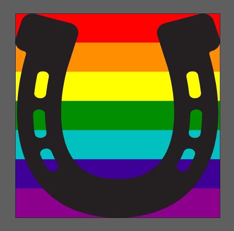

Now I need to take that complex horseshoe Compound Path and fill it with an image. I haven't been able to make that happen. Keeping the horseshoe compound path on top I tried the following:
  • Subtracting the horseshoe from the image -> I figured if I could get that to work, then I would just use an invert select command
  • Select image > Image trace > Expand. Then drag the horseshoe path into the resulting group of expanded image parts. This works but doesn't seem to be editable. I'd rather have a repositionable non-destructive method if possible. Like a mask of some sort.

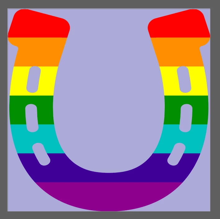

(This is the final desired look, that I achieved only by image trace and expand, but the rainbow image is not reposititionable or scaleable - lavender background used for contrast)
The issue seems to be, as far as I can tell, that my horseshoe is a compound path and you can't use a compound path as a mask. So, how can I convert a compound path into a single shape so that I can use it as a mask?

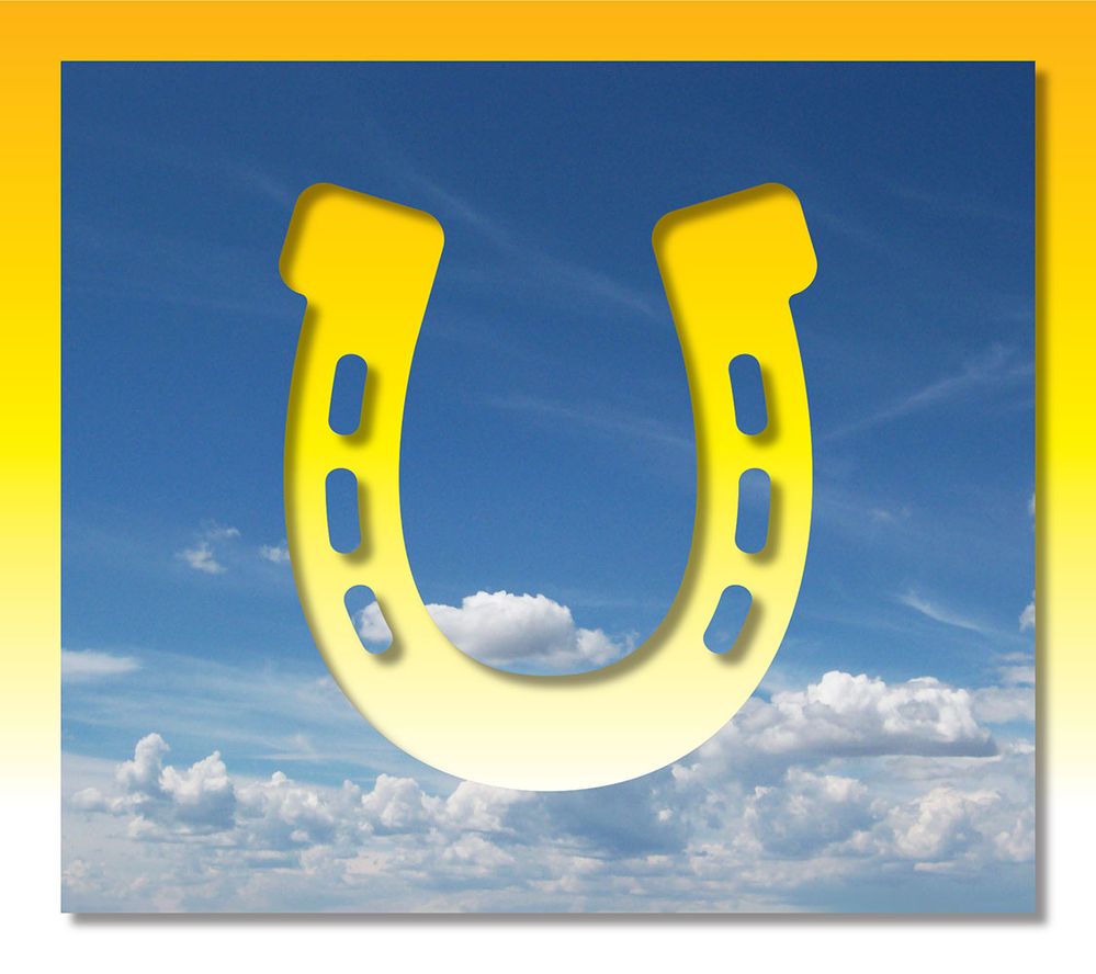

May 14, 2023
I put together this example just using a compound shape of the horseshoe graphic and a larger box as a clipping mask. I don't have to use pathfinder operations or tricks with opacity settings to accomplish it. Pretty simple stuff really.

May 15, 2023
In the other discussion thread on this topic I thought you were wanting to use the horseshoe graphic to literally knock a hole through an image. So I created the earlier example of it cutting a hole through a sky image. Doing the inverse, just making the sky appear within the horseshoe graphic itself, is easier. You just turn the horseshoe graphic into a clipping mask, like Monika and Doug suggested.

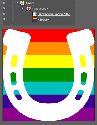

CodeSlayer2010
May 14, 2023
Thanks @Monika Gause. The result I get is a white horshoe instead of the desired rainbow horseshoe.
I tried reorganizing the layers so that the image was on top, but that version did work either.

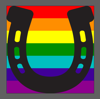

Jacob Bugge
May 14, 2023
CodeSlayer,
It ought to work with the Clipping Path, but in any case you can use a(n opacity) Mask with both Clip and Invert Mask ticked (when the horseshoe is still black, when white you need to have Invert Mask unticked). It is in the Transparency panel.
May I ask why you are using an image with the coloured stripes instead of vector rectangles with solid colours?
That would also enable you to use a simple Pathfinder Minus front/Subtract from shape area and have simple paths, which would also be the best way in connexion with the (possible) use as a logo.
