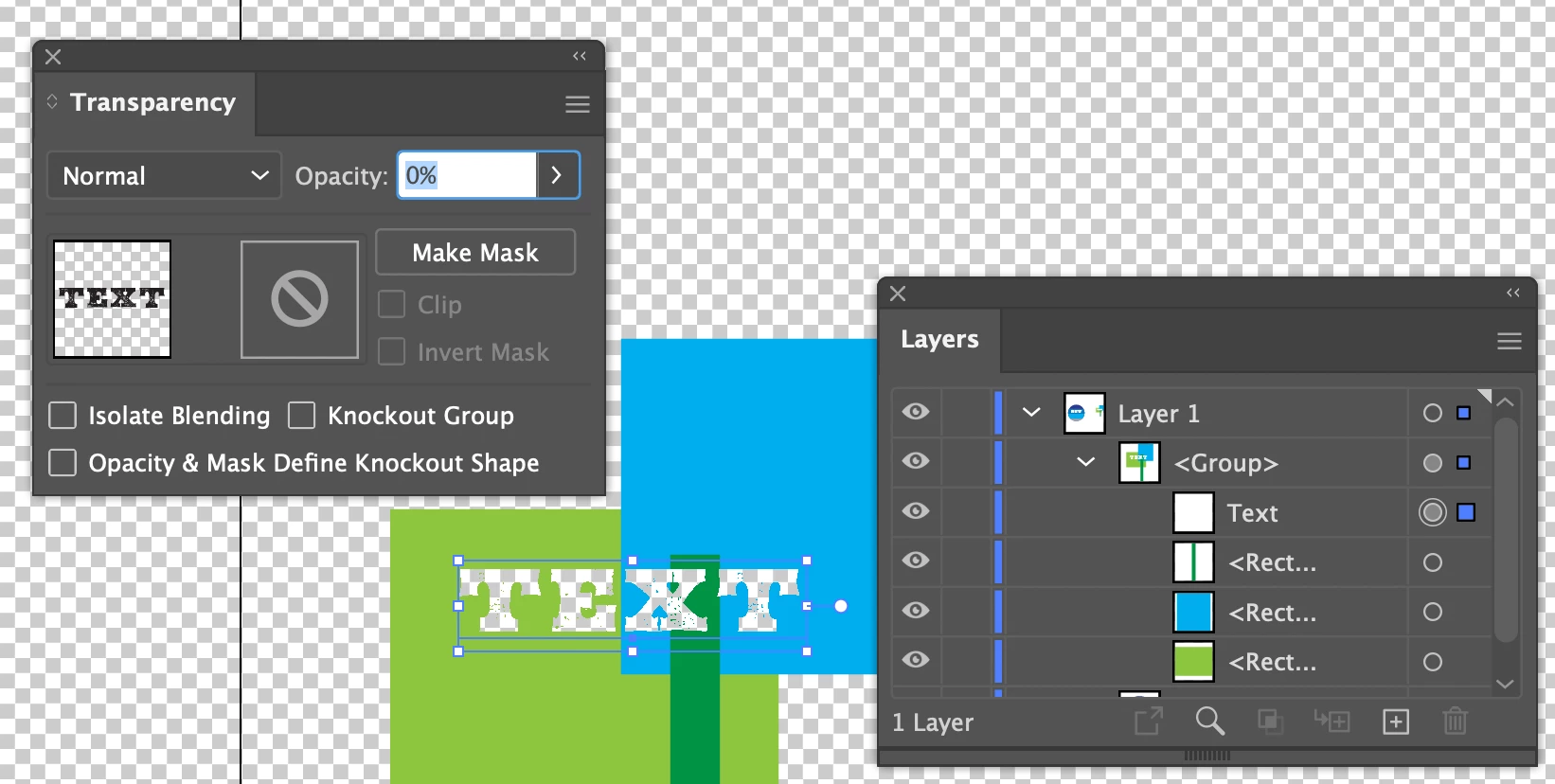

November 8, 2021
I used a clipping mask to join all of the strips inside the circle, then put the live text on top and used the Transparency Panel to make a mask of the live text. (The gradient underneath is to show that the area is now transparent)
